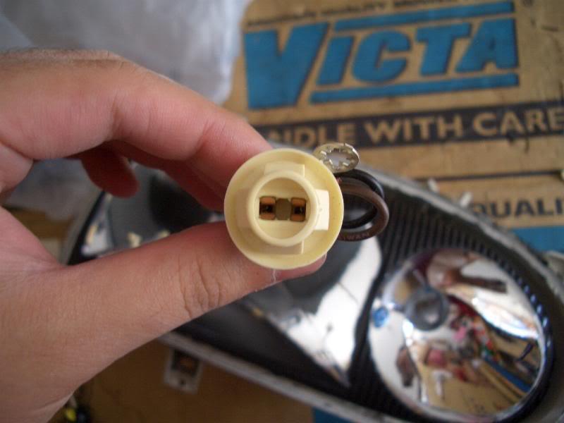

I integrated my front turn signals into my stock headlights. For me, the blackened stock dual chamber headlights just beats any other look, so I was determined to keep them and have my shaved bumper work.
I bought bulb holders from AutoLumination and also a bunch a few LEDs which ended up being rubbish for my application. I picked up a set of wedge-type orange bulbs that we use for our side indicators and they work fine. Anyway, here's the bulb holder:
After removing the lens (it now takes me less than a minute each haha), I drilled a hole through the headlight. I used epoxy and superglue (yeah, bloody ghetto) to attach the bulb holder on.
Since I had the headlights apart, I used some acetone and some of my breath to clean up the reflective areas. It did a decent job of clearing up some clouded areas. I then proceeded to lightly sand my headlight lens (1000/1500/2000 grit), applied and buffed cutting compound and plastic polish and the headlights came out looking like new again. It was something I experimented with on my cousin-in-law's FUBARed Passat headlights - didn't come up as well on his as it was our first time though. I wrote a DIY on that if anyone wants to clear up their headlights.
When it came to resealing, I wiped and dried off acetone on the inside of the headlights first. I learnt in science lab that acetone works as a drying agent, so I'm thinking it won't cause any condensation. I then used A LOT of sealant to reattach the headlights back together, and now I get no more condensation
. I was quite happy with that.

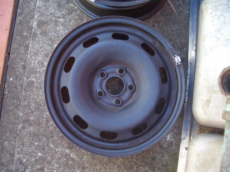

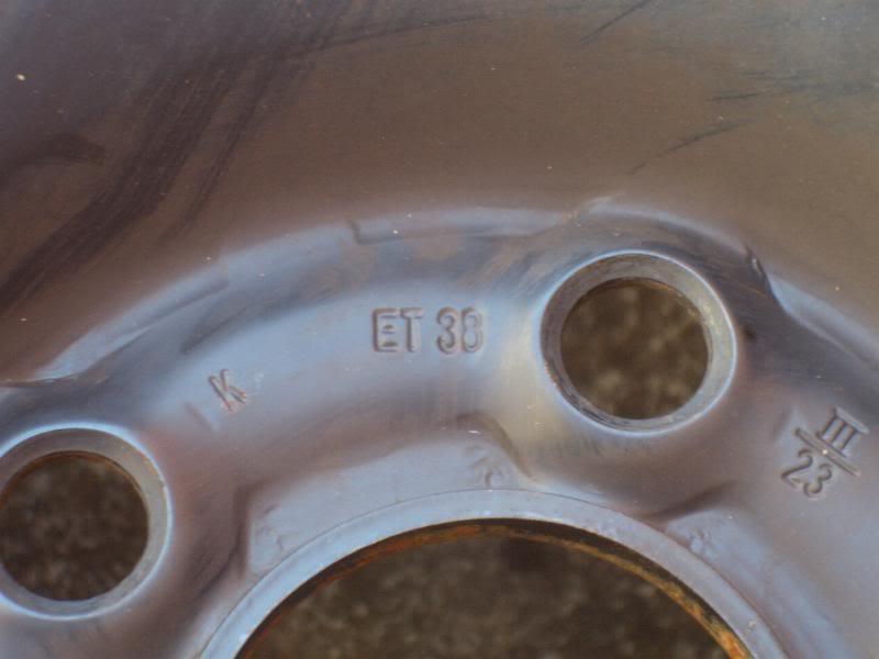

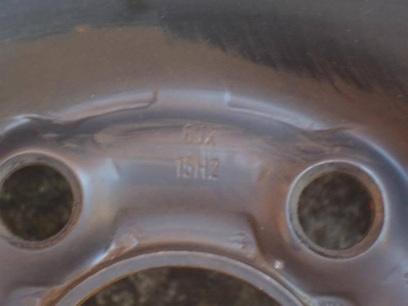

I've sold my Work Equip wheels to make way for another set of wheels that will (no doubt in my mind) finally work. I have a set of steel wheels with hubcaps in the backyard waiting to get some custom work done. I just hope the hubcaps will still fit on after the custom work
These figures will need to be changed too
They're not gonna be too crazy, but hopefully should look good.

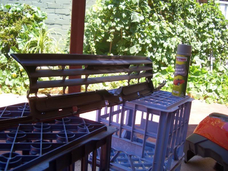

My badgeless grille is nearly done too. It's painted already, but I just gotta have the bottom notch welded smooth now.
