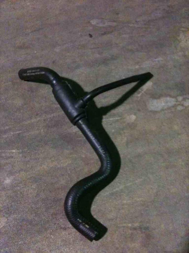

    If its the hose I'm thinking your meaning. I have a spare. I'll take a pic when I get to work to see if it's the right one

        Pretty sure I know which one you mean, it runs to the throttle body? I'd just give that description on the phone to some parts places and they'll figure out what you mean, not sure what its technically called, id just say the heater hose with a hose running to the throttle body about half way along.
        ---------- Post added at 02:42 PM ---------- Previous post was at 02:38 PM ----------
        This one? Volkswagen Golf III VR6 12v > Engine > Cooling > Hoses > ES#2490 Coolant Hose - 3 Point Hose - 1H0121157H
        The part number in the US for that is 1H0121157H, although sometimes the part numbers for things over here are different, and that one might not be recognised. For engine parts like that though theyre often the same.

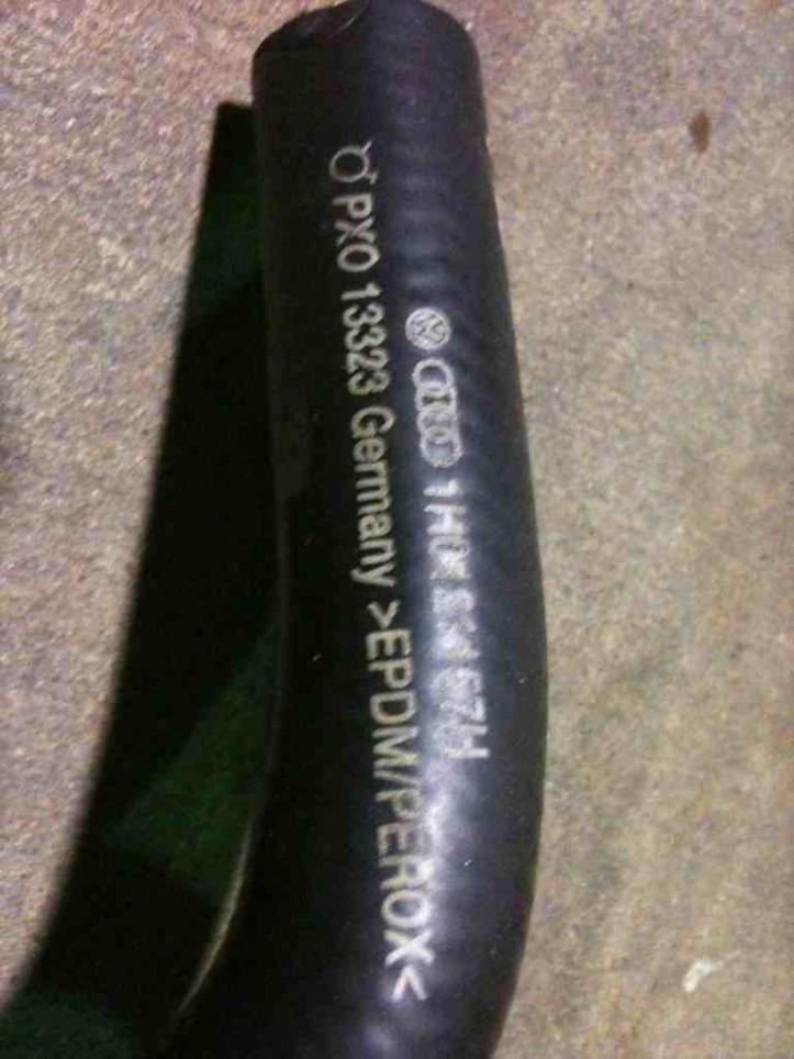

                  The part I have is 1h0121157h. Its genuine vw part. Let me know if you still are after it.
