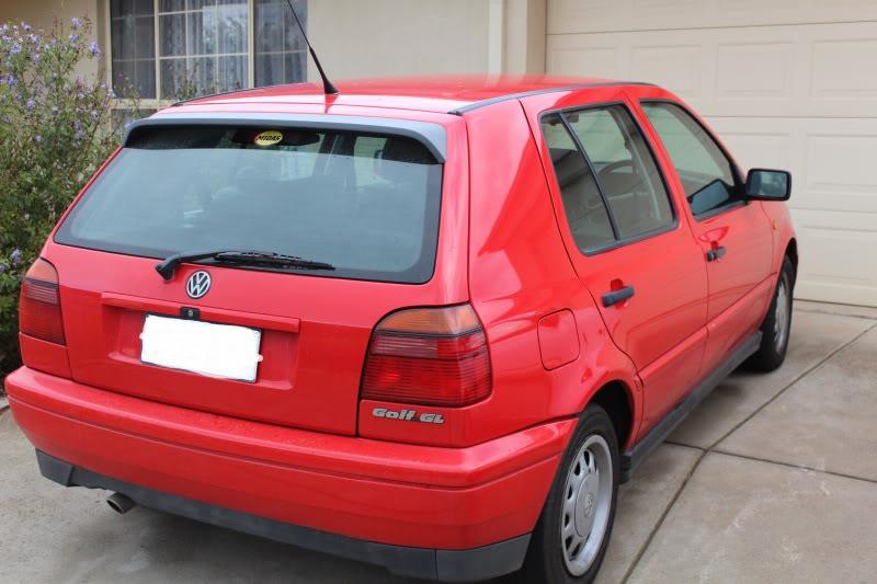

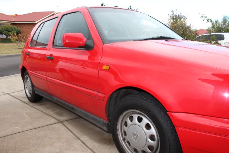

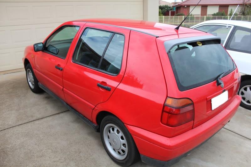

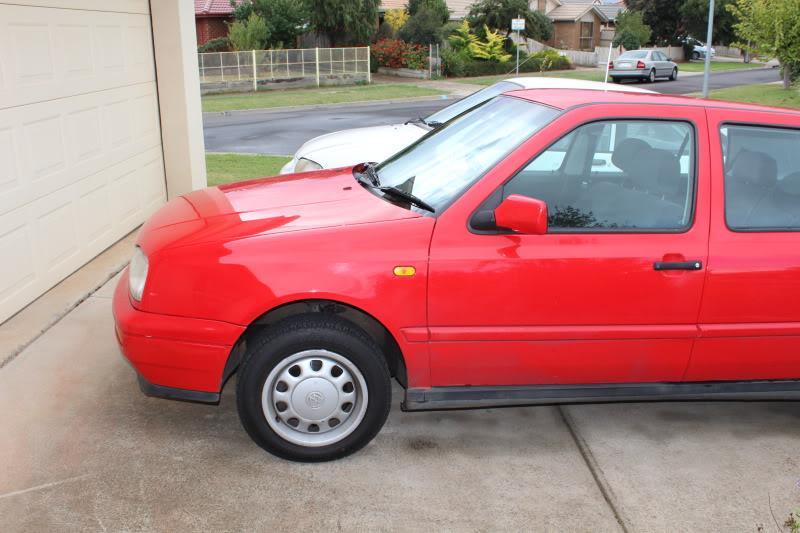

            finally got round to taking some pics...
            1974 1300 Beetle, 1997 Golf GL, 2003 New Beetle Cabrio, 2014 Audi A4 quattro
              That looks very clean, congrats on the purchase!

                  She needs some lows i must say .. Lower it so you can load your shopping easier :p
                  VW BORA 2003 V6 4Motion
                    Looks nice,but needs a trim ring on the right front wheel...
                      lol... something else to chase up...
                        That red looks to be in amazing condition, keep her garaged and she won't turn pink on you! haha.... blacken those bumper strips too and she'll look a million bucks
                          Great buy, good looking and clean, congrats. KI11Z hit the nail on the head; keep the car out out of the sun as much as possible, feed the paint with polish/carnuba and "Forever Black" on the trim bits to keep it looking good.
