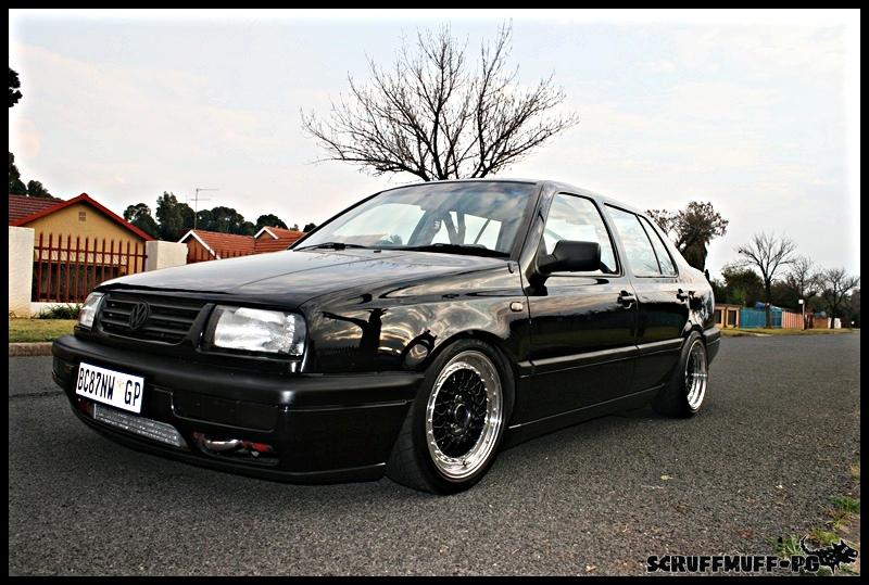

  • #16
    Pornographic!
    • #17
      Originally posted by Bflat View Post
      Pornographic!
      THIS..
      now i want one even more lol
      • #18

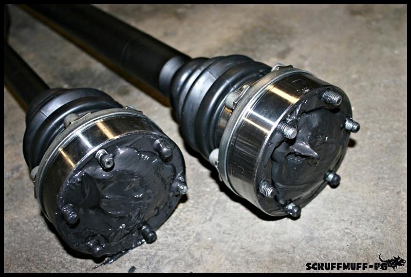

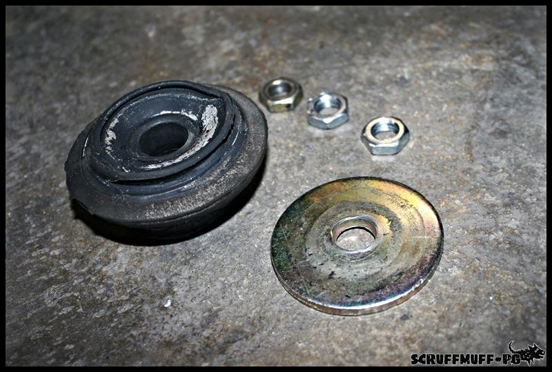

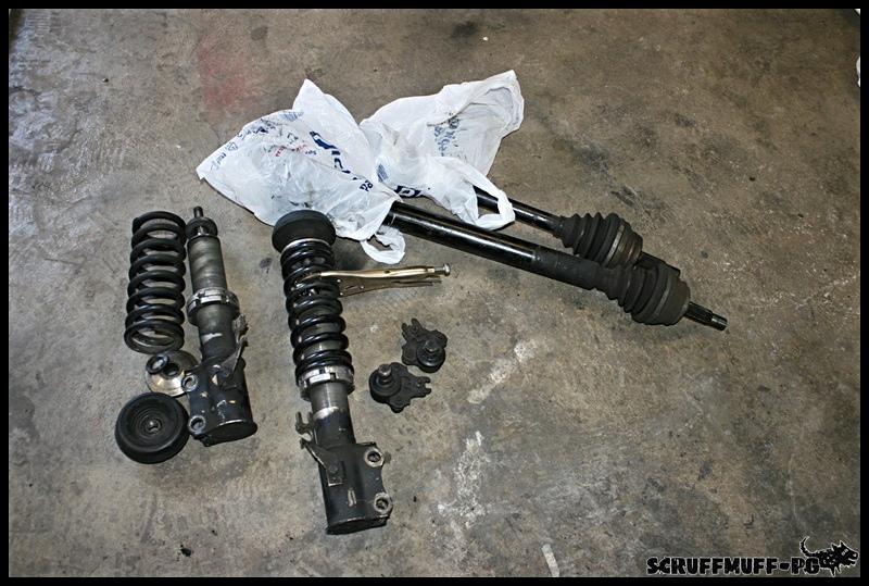

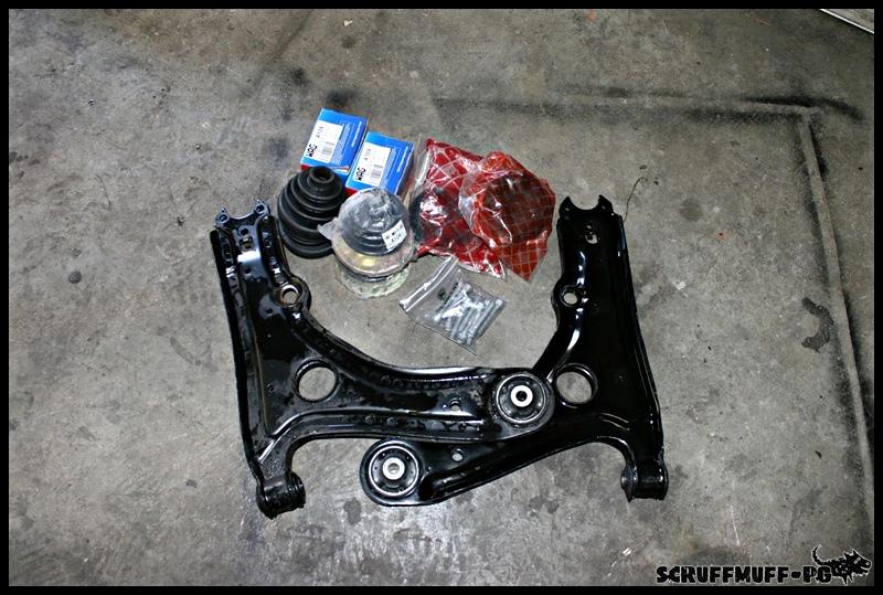

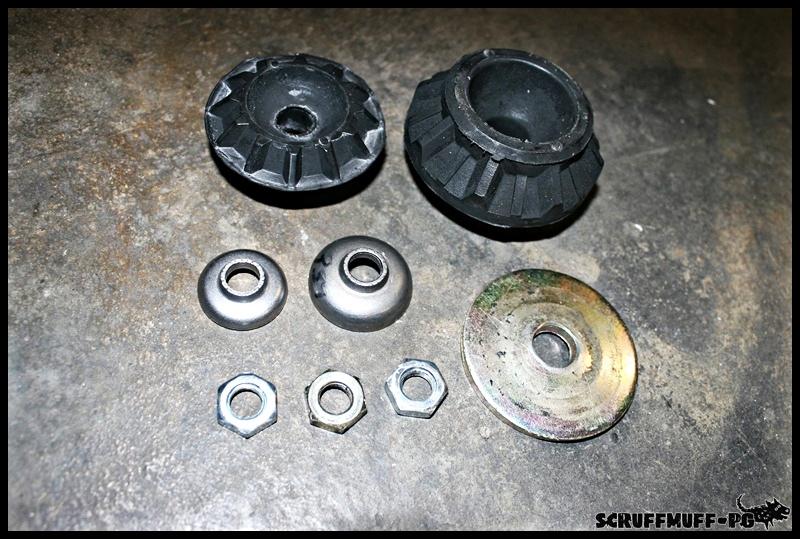

                So bad luck strikes once more with this POS jetta.
                Picked up a vibration on thursday which became hectic friday on the way home.
                Started stripping the front suspension to find, control arm bushes worn moertoe, balljoints had so much play looked like a earthworm flopping around, both coilovers f**t, they dont even compress out by their own anymore, the left hand side shaft where you insert an allen key to loosen the top nut was completely rounded off and the nuts which hold the shock mounts seized and both shock mounting bearings seized.
                So everything stripped out the car, if fuel wasn't so expensive i probably would have set it alight!!!!

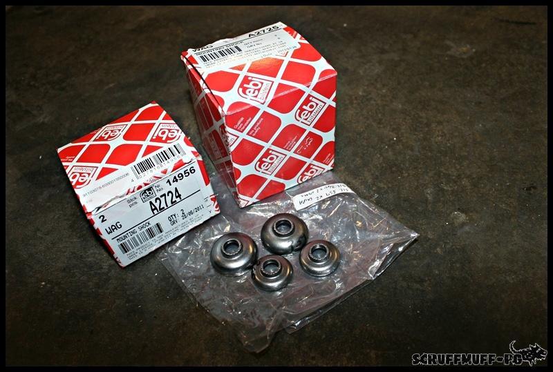

                New items purchased:
                2 x Febi control arm rear bushes
                2 x Febi control arm front bushes
                2 x Febi Shock mount bushes with bearings
                2 x Balljoints
                12 x New CV bolts

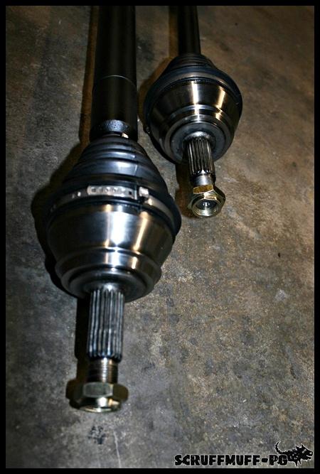

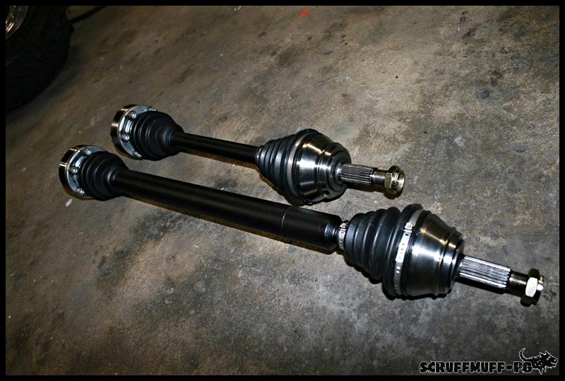

                CV shafts were given in by Sajco to inspect them for any damage and to service the joints, but turned out all 4 CV's were f**t and could not even be reconditioned. So 4 new cv's were fitted and shafts checked for balance.

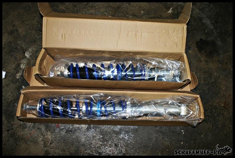

                Then I made a call to DDM imports, and he offered me excellent and speedy service, so last night I collected a big box from him...

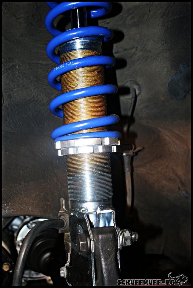

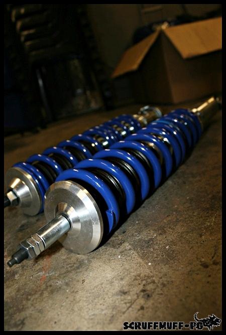

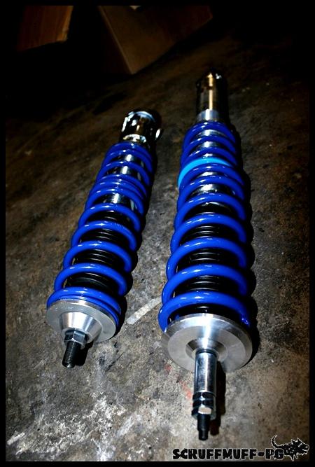

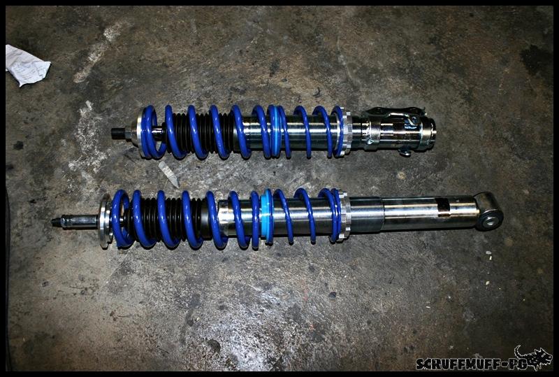

                        Righty....
                        So these are the parts that came out of the rear setup.
                        New parts purchased.
                        Correct parts going back in.

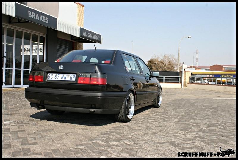

                        And just a pic showing the coilovers fitted, fronts were adjusted to 55mm with helper springs removed.
                        And some pics of how it looks with the new acquired lowness.

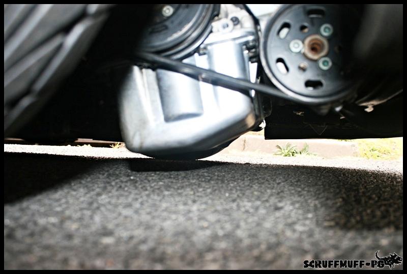

                        But then raised it 10mm sat night, and still need to raise it a little bit more, knicked the sump twice on the freeway already

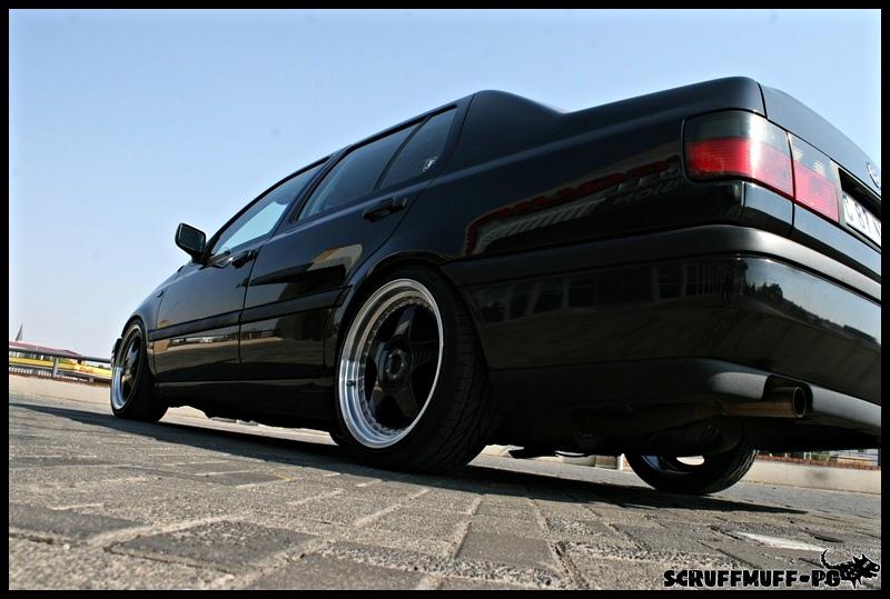

                            • #29

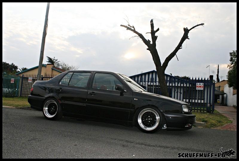

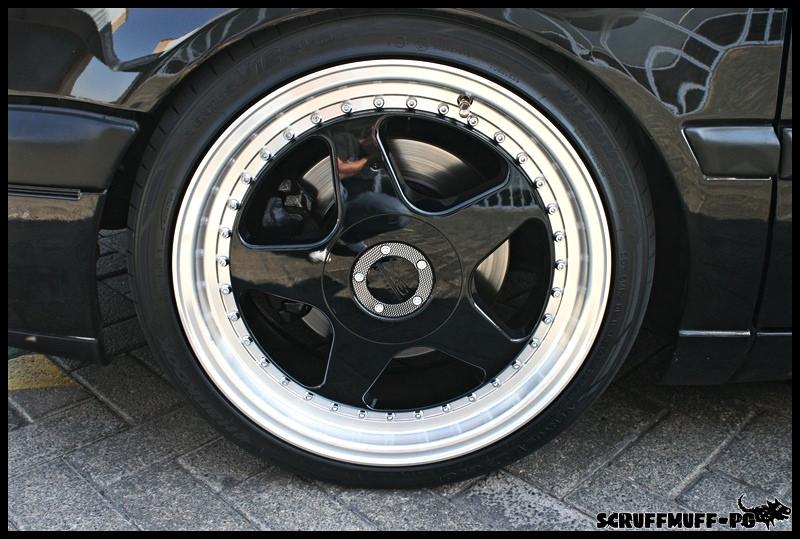

                              Was tired of the wheels, so went out this weekend and got a new set.
                              Just waiting for my rear spacers.
                              • #30
                                man, it's such a clean ride but your killing it for me with all these knock-offs The "futuras" are a timeless design and suit well though....
