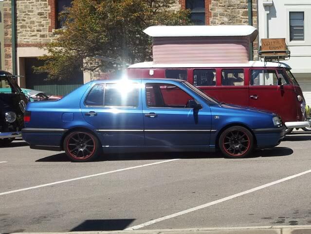

                      just to help put an image to it
                        is it the front you want lower? the rear height looks fine, drop the front another inch and you'll be apples... (imo...)
                        :edit: too much shade on the rears too :p
