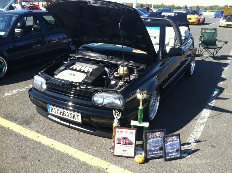

              yeah not really worth converting a 4 door mk3 as you can just buy one thats already a vr6 for less money and do that up. Trust me there will still be plenty to keep you busy if you are looking for a project! If you are set on converting your car you have - maybe look at a more interesting conversion? Say an r32 or check this out:
              If your exploring engine swaps VWvortex.com is your go to source for this stuff as if theres an engine swap to be done someone on this forum has done it! Turboing whats in the car now might be an option as well?
