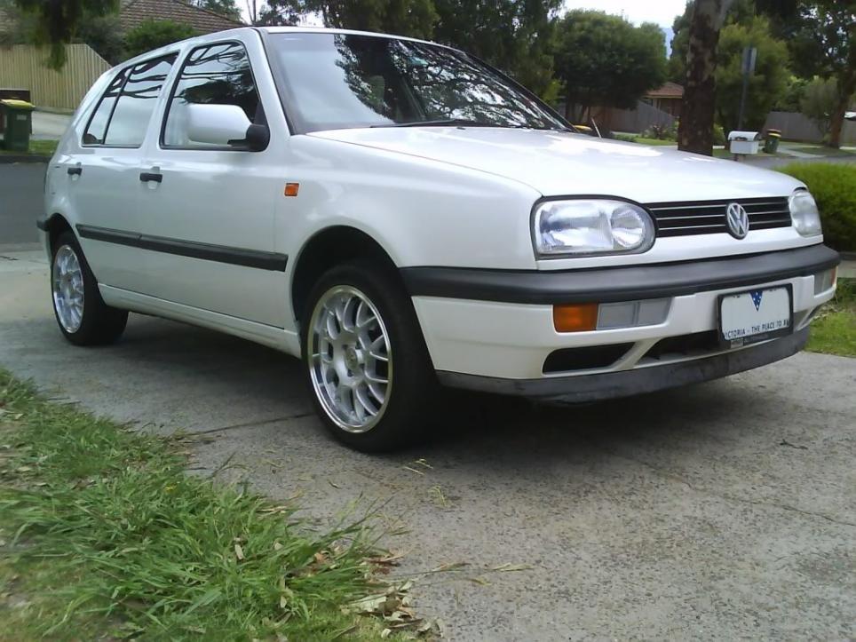

    Now that I've owned my car for a year now, I feel like I should properly introduce my car.
    This is a 1995 1.9 TDI
    Will do a nice photo shoot soon.
    Great car, goes forever. Really good for cruising.
    Right now I'm getting 900 - 950 KM on a single tank So I'm doing something right

          nice straight looking car mate.

            looks pretty clean - I'd do this too it if I was painting the trims
            or hit them with forever black so they are nice and black. Look forward to seeing what you do with it either way!
