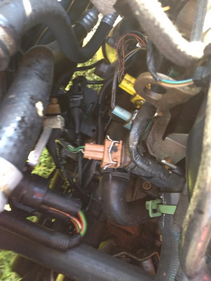

      thanks mate, here's a photo of it:

        looks like you may be up for a new thermostat housing buddy .

          those sensors all have clips that hold them in place. Is it possible the clip is missing so its not staying in place?

            Looking into it more, I found a clip that is broken. Here are a few more pics. And I don't think it'd need a thermostat replacement, it looks like it's just the clip.
            This is the clip above.
            This is where the sensor connects. The plastic clip fits into the slit to hold the sensor it place it seems.

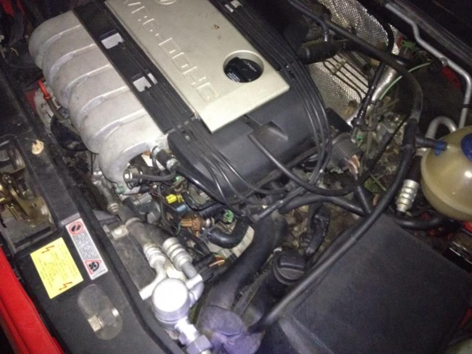

            I still need to get home, bit over an hour and a half from here and I don't assume that anyone on Phillip island has some random Volkswagen clip. Any ideas of what I can do?
            The next photo just gives a bit more perspective of where it is that I'm talking about:

              You might be able to get away with just putting in a new clip , or you may need a new o ring and even maybe a sensor too. If those dont work, then yeah, themrmostat housing too
                Got it all sorted, turned out to just be the clip, a cable tie did the job for the way home, no leaks, and got one of the clips for free at volkspower. Thanks for the replies
