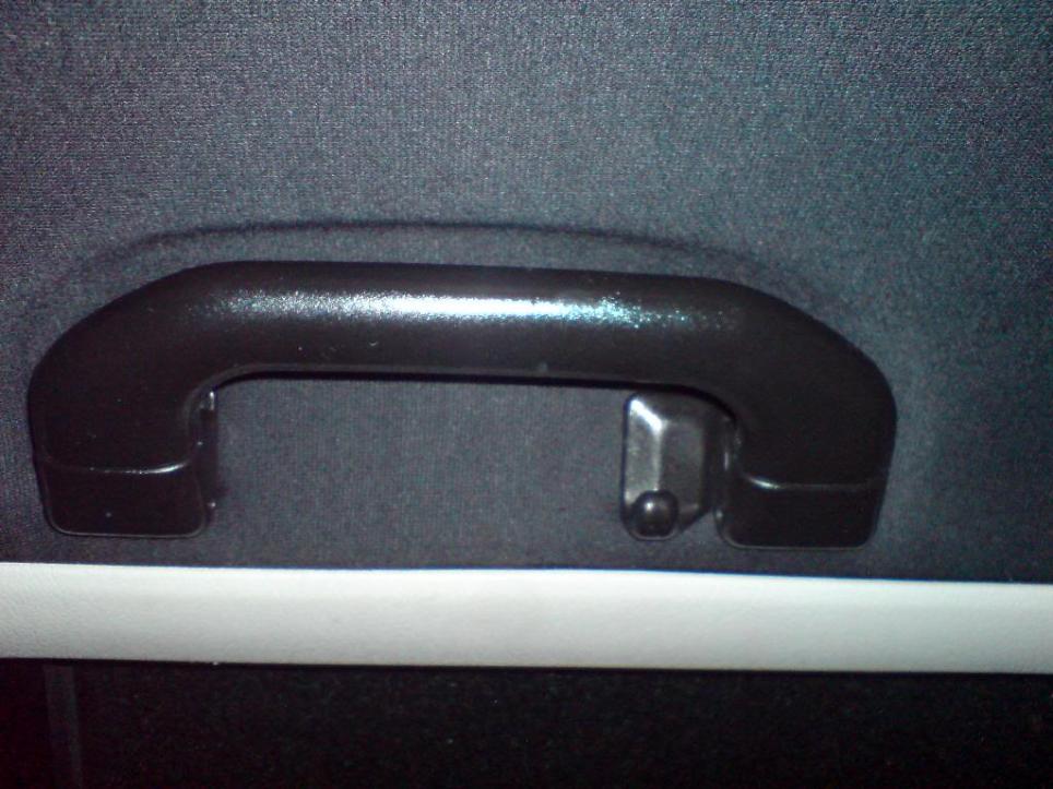

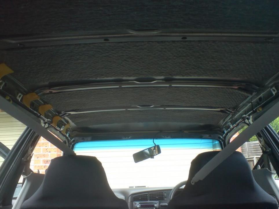

      first I started by taking the handles, sun visors and centre light out - i forgot to take photos of this bit, its simple enough... - just a matter of taking the screws out.

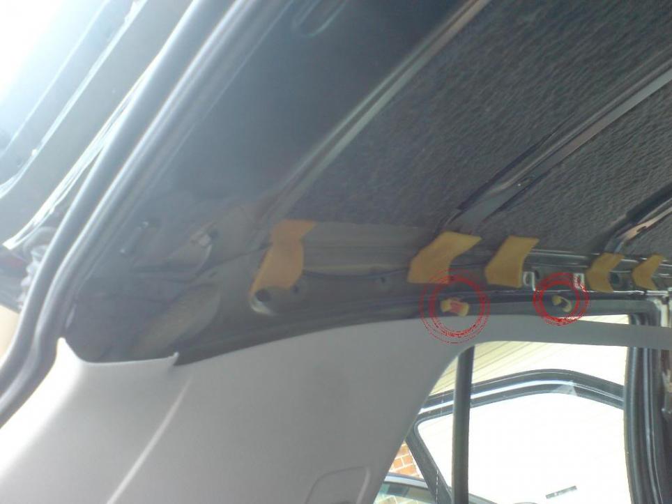

      the next part to come off was the plastic trim part that covers the centre pillar (the one with the front seat belts) - simply pry it off with your fingers. Behind this part is two screws to hold the trim that covers both the front pillar (next to the windscreen) and the rear panel (with the rear seatbelt cover).
      Undo these and pry the trim off.
      You may run into a bit of difficulty getting these parts off and it will be because of these little f#ckers... (circled)
      they click onto the back of the trim and the snap into the roof. be careful when you pull the back trim off the rear wall as there is big snap lock things that hold it in place.
        Now i'm not sure if this is supposed to happen, but my headliner was attached to the windscreen by silicone... i'm pretty sure it's not supposed to be (probable broken windscreen) but the way i got around it was with a bread knife and some patience.
        after the silicone was removed, the headliner just slid out the boot with some help from my bro. as science said, easy as.

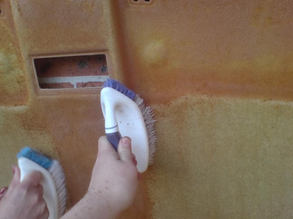

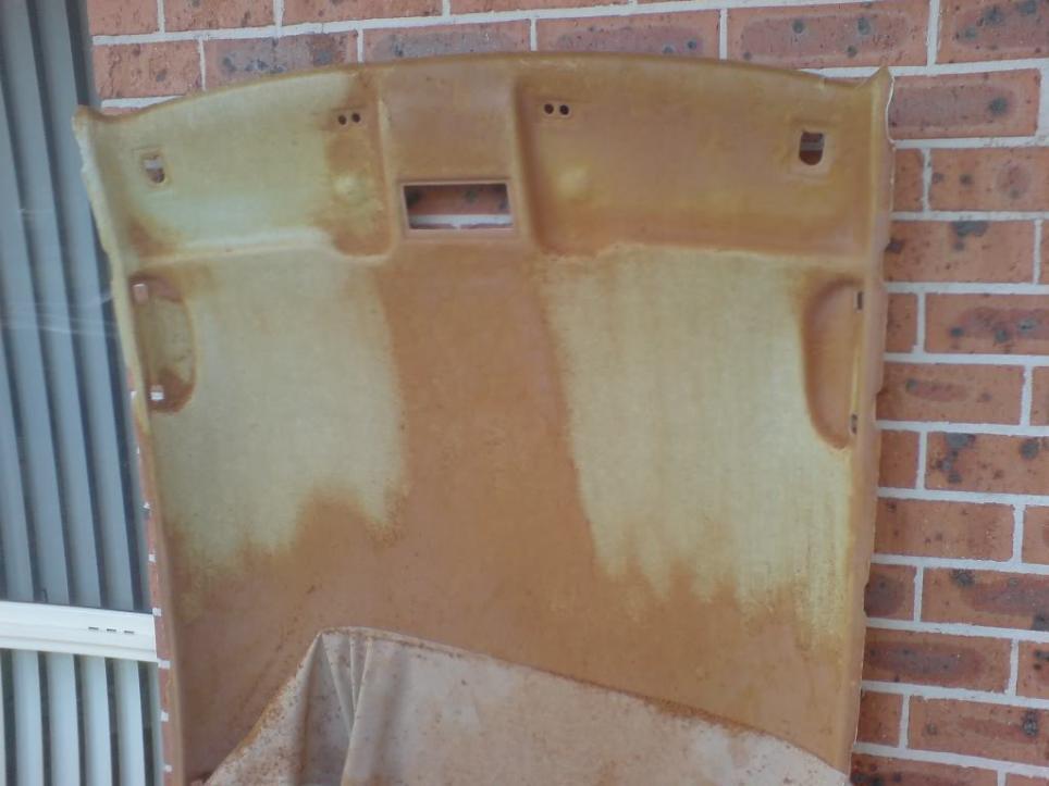

        Once it was out, i removed the old fabric which had foam behind it. The foam had been in there too long and started to deteriorate and go sticky. I was just wiping it off but then Mum had a great idea.
        Use a scrubbing brush!
        This worked really well, just don't do any of this in a windy place, the foam stuff goes everywhere...

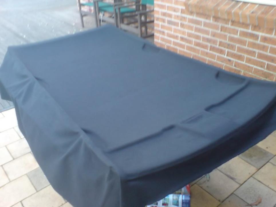

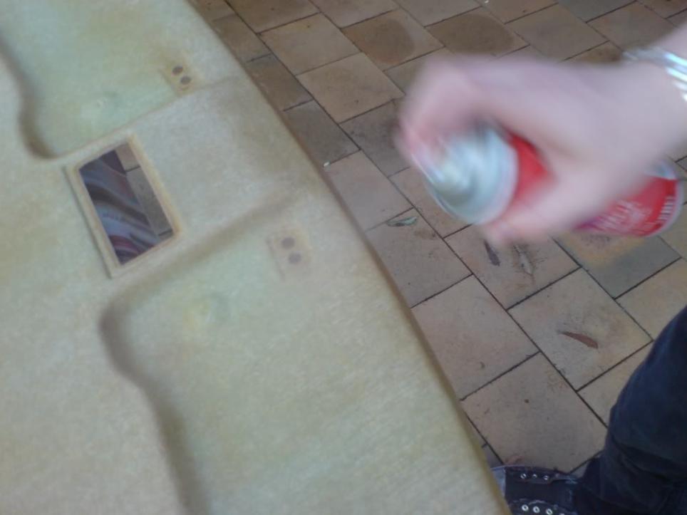

          I laid the headliner on a table and placed the fabric out on top (I ironed it first). Using a can of spray adhesive, i coated both surfaces generously and waited for them to become tacky.
          After it was tacky, i smoothed the fabric out and worked it into the moulds.
          I did this to the other half and then left it for about 2 hours in the sun (not really necessary but i wanted something to eat. haha.
            I cut the excess fabric off and then decided to leave it for the day

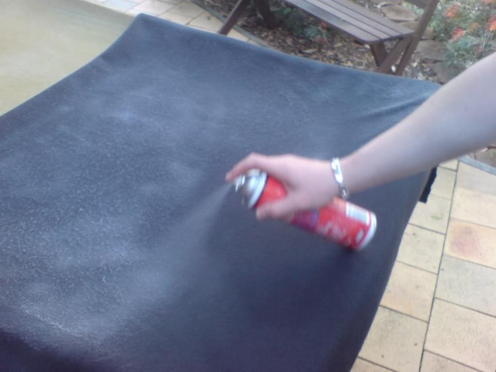

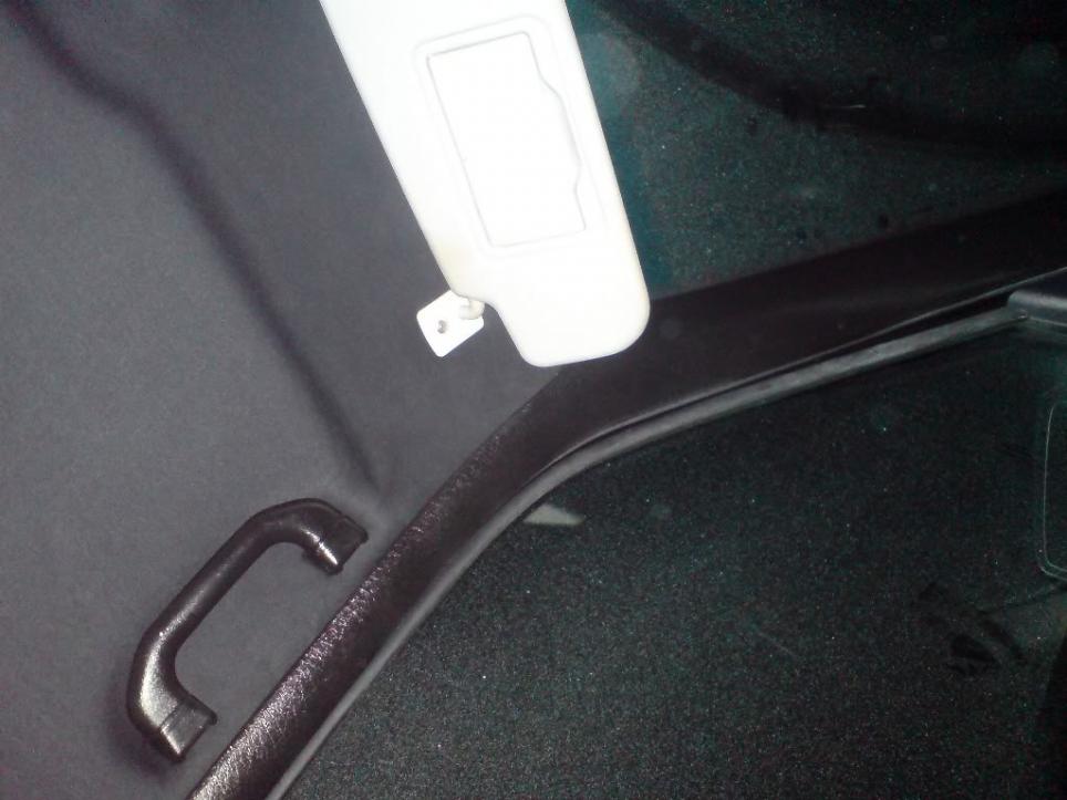

            Thinking about the whole ordeal over night, I decided to buy some vinyl spray and coat the trimmings black too.
            This was really the first time i had done any spray painting on anything other than flat surfaces but i really did learn alot:
            • apply lots of coats lightly, DON'T apply one thick one.
            • when it says to spray from about 25cm away, do it.
            The crappy paint job isn't really that noticeable, but it could be better.

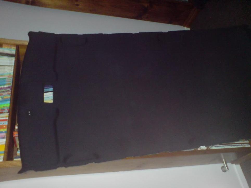

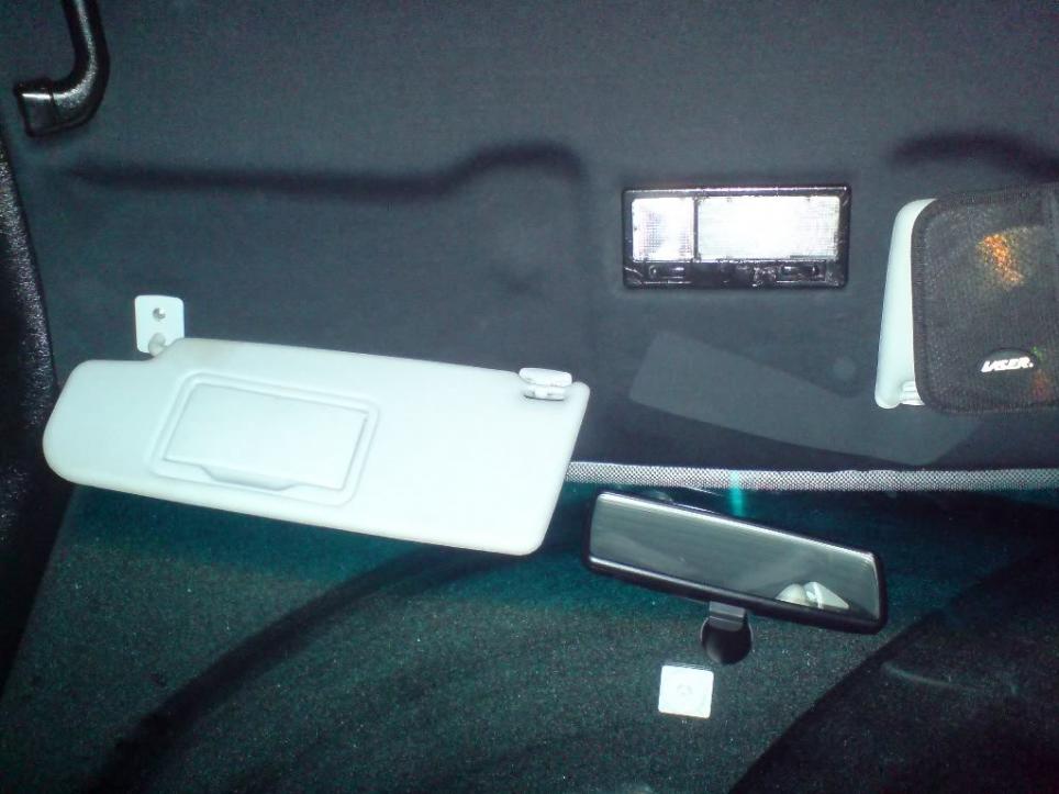

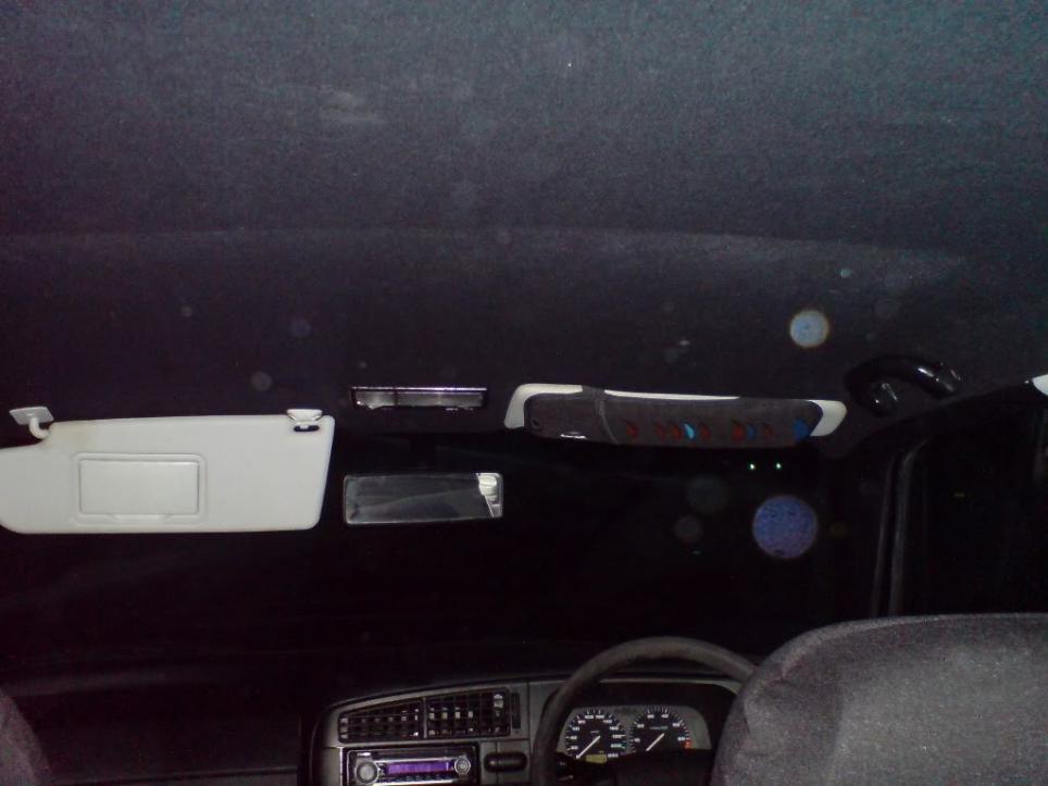

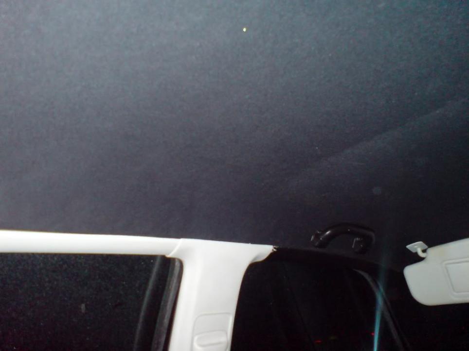

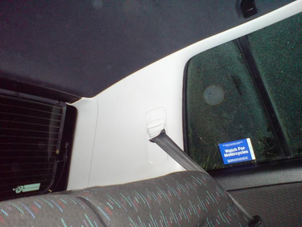

              And here is some dodgey late night photos of the finished product.
              pay no attention to the dirty windows!!!!!
                  As for the centre and rear pillar cover trims, i couldn't be bothered taking the seatbelts out to get these particular parts out, so I am going to buy another can of vinyl spray and do them next weekend...
