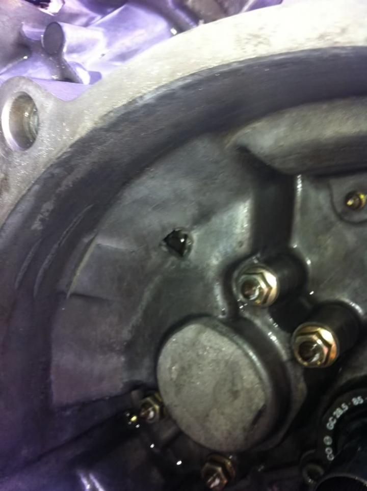

hello, as i has blown a hole in my gear box i pulled it out today and pulled it apart to see if i blew the spider gears or a rivet on the crown wheel. as i stripped the box i inspected the rest of the bearings, gears and syncros. and it all looked good as for the diff i blew the spider gears. so i am going to replace with a lsd. and for the hole in the box tig welder.
