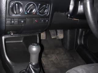

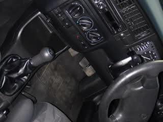

        So next little thing was removal of the chrome gearknob and replace it with something a little more OEM.
        A 'MK4 GTi' gearknob of fleabay.

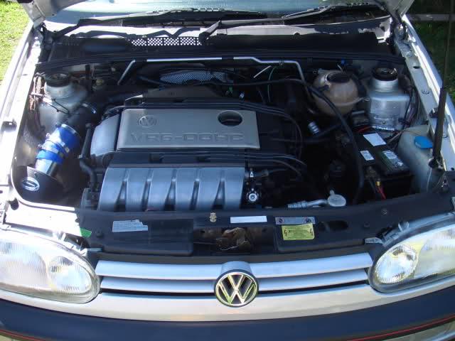

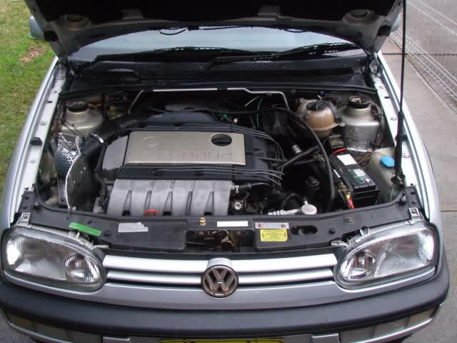

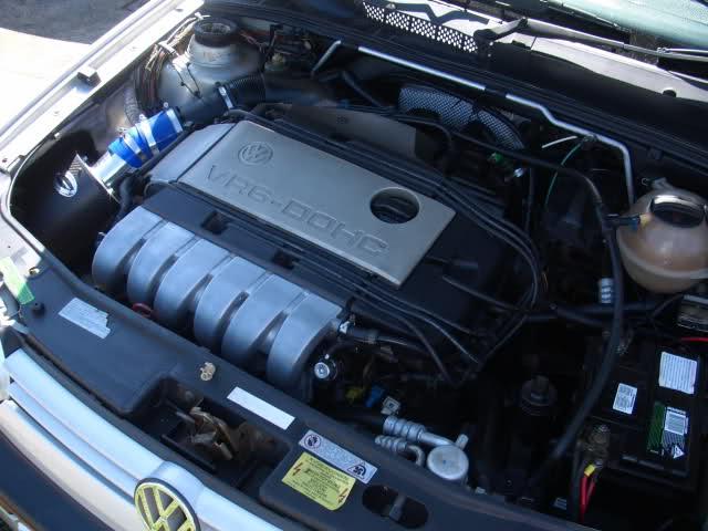

          So on this sunny change of a day, i busted out the wet n dry and from a little toy from jamie this was the result!
          Before:
          After
          Unfortunately the photos were taking in the shade so it isnt as shiny
          Its actually not really visibile at all, i sanded up the intake manifold and the side valve cover..

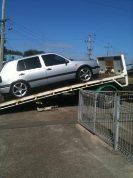

            A sight you want to see in the morning
            • #51
              What happened to it??

                Driving it the other night, started ticking very loud and oil light flashing.
                So first thoughts are the oil pump has gone in it. It's at the mechanics now getting sorted. Hopefully have it back soon.
