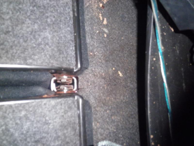

    the base of the seats are easy enough, just an alum key and bang... BUT the back rest is where I'm stuck. I've got the outside edges loose (out of that stupid cavity), but I was wondering how to get the centre join loose...
    This...
    haven't worked out what to do there yet......
    Ideas?

      The clips come off and then lean the seat back up again and push towards the middle of the car and pull up...comes straight out!
        Awesome mate thanks heaps for that... just force together with pliers or something like that? I'm going to butcher the spare back seat and use it to restuff the bolsters that have gone a bit flat.

            Cool, backs weren't hard, those screws on either side are fiddly though bit awkward, must be a special tool to get in there.
