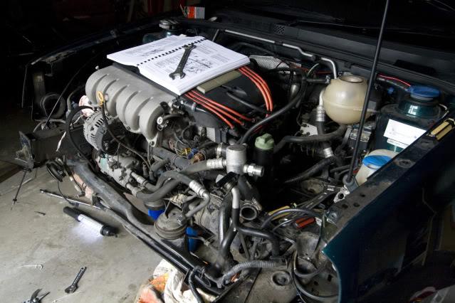

    hey guys,
    so currently my engine like this...
    it should be out tomorrow,
    and ill begin doing the timing chains followed by my new clutch..
    i was wondering, cause its been such a **** fight,
    what else i should look at doing before it goes back in.
    its got 150000km's on it, and personally i never want to pull the thing back out hah
    anyways, as always, all advice much appreciated.
    Paul.

              hey guys,
              so ive narrowed it down to the things ill look at changing...
              1. crack pipe, which isnt at all leaking, just think its probably a good idea. 'just in case'
              2. silicone hose kit? does anyone know of ones in aus, as im not really looking at having to have the engine out whilst they internationally shipped
              3. new thermostat
              4. Possibly a catch can setup? i thought instead of replacing the pcv hose with a breather i could use that?
              ohh and ive degreased the engine, intake manifold and cleaned the throttle body...
