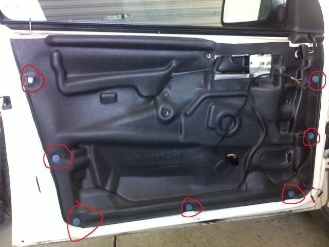

    So I am up to this bit
    What do I do next? My guess is to remove the bits that I have circled? Is there a trick to it or do you just lever em off? I am trying to be as gentle as possible up to this stage.
    I've always left those in, the foam had been ripped around them anyway
      I guess they are not what holds the vapour barrier on, it's the black glue stuff that holds it on. So I could rip/cut around those grey things, but I would prefer not to if I can some how get em off.
        Yeah I tried levering just one of with a flat head screwdriver but it didn't seem like it would work. Looks like it will be best to cut a thin slice through the vapour barrier and just move it around the clips. I will wait though and see if anyone has any better ideas.
          Yeah I'm gonna slice through the glue with a knife so as not to rip the vapour barrier.
          But yeah looks like I will just make a few slits to get around the clips.
