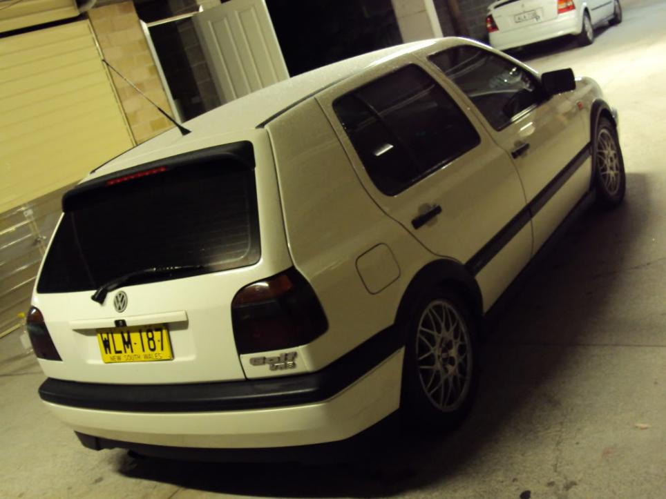

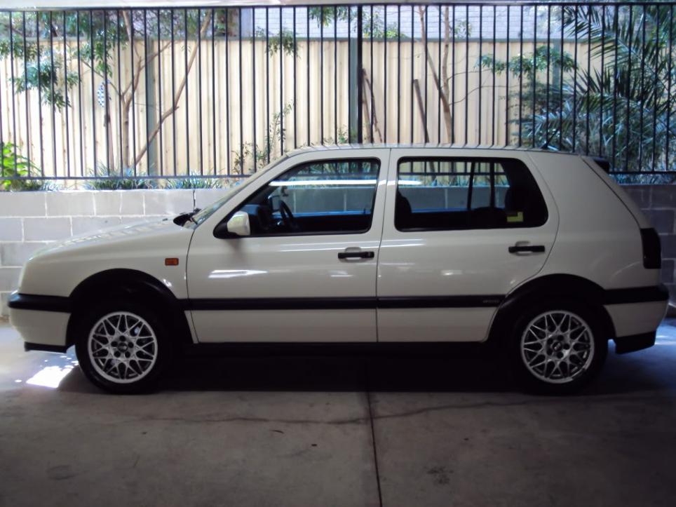

                  I have hottuning coilovers wound right down (have 2cm of thread or so left) and the ride is pretty firm, but i like it a lot. If you were to have the coilovers at more of a sensible height im pretty sure they ride a bit better too.
                  Oh and needless to say getting rid of some of that wheel gap makes all the difference to the mk3.
                  before - after a touch of hottuning

                      sportofbigbj , mate you ride looks sick ! thumbs up !

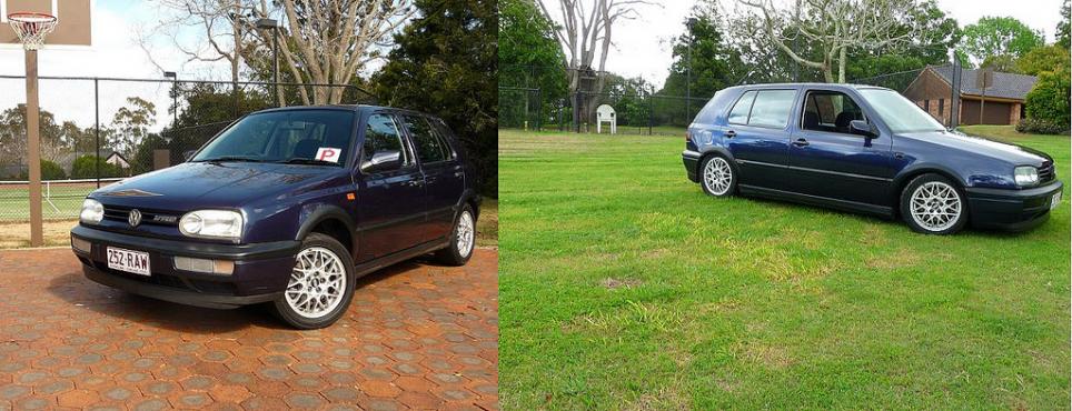

                              Mate i got mine from Slammed Distribution ( evorobin or lorenz ) for $800 flat delivered 2 my door... It was a package which came with the coilovers, front strut top mounts, bearings, keyring & a sick ass Slammed Distribution t-shirt with a picture of a slammed Golf mk3 on the back . All was dropped off within the a week and the piece of mind knowing the boys where only one PM away if i ran into any troubles . Not sure if they still have the special package but im sure the boys will look after you.
                              FROM THIS
                              TO THIS
