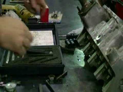

          Bolt places, or engineering suppliers have them.
          Process isn't too challenging but does involve a few tools you might not have.
          Take a look at this
          Probably best to take one of the bolts with you to make sure you get the right size.

            I use the recoil kits myself. A lot of places stock these.
            Recoil | Thread Repair Kits
