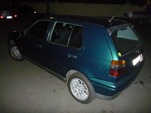

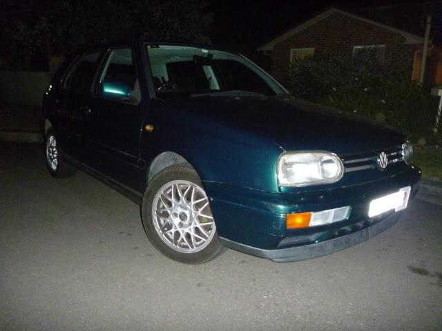

              okay, so here are some photos,
              fairly dodgey, but im going away on retreat for school tomorrow, wont be around for three days,
              the car overall's pretty straight, i mean theres the old scratches and stuff, but nothing a little money cant fix.
              as i said im going away so it wont be be before saturday that ill get a chance to properly wash it and give it a polish. i also want to repaint the little spoiler on the back, and possibly the handles, any recommendations?
              ohh and if anyone has the clear foglights lying around, i'd love to buy them
              or just a clear piece to replace the orange one
                Use kiwi shoe polish to get it back to black (spoiler and handles) search it.
                Get a euro VR6 lip.
