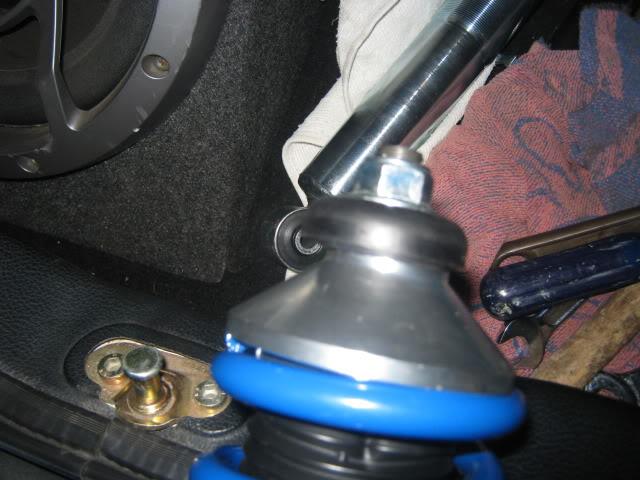

                          Nah haven't even got to the point of putting the front ones on the car. There is just not enough thread on the strut to fit on the bolt, the bearing, and then put it through the mount and the cup shaped stopper on the other side of the strut tower, and then finally put the top bolt on.
                          I have the top hat thing tightly on it's stopper and there is just hardly any thread left to work with...The oem suspension had about 1cm of thread left poking out into the engine bay, as did another pic I just saw of some aftermarket coilovers. This is what I am working with:

                              Not 100% sure what you mean by 'a'. But I'm pretty sure I have tried 'b'. That pic above is with the coils adjusted all the way down to the bottom. The top hat thing is resting as low as it possibly can get - it is hitting it's stopper. And that hardly leaves me any thread to work with...

                                That nut on the fronts might not be tight? To hold it down I use a spanner on a spark plug socket to tighten the nut, while using a hex bit (allen key works) on the top to prevent the whole thing from rotating as I tighten that nut.
