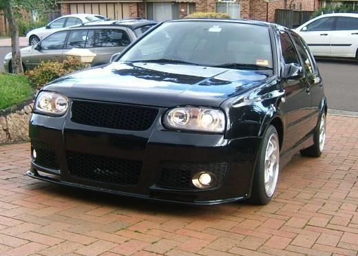

      Originally posted by madglf3 View Post
      It looks like this type of bumper, or at least with the rubs added - the top is too flat to be the proper 3.5 bar (below).
      Like it's a hybrid or something.
      Cause its actually a mk4 rear and front bar... You can do the conversion however its a fair bit involved, as you need front and rear bars, front guards, reo bar and bonnet. This also means that you will have to change your lights and grille to suit mk4

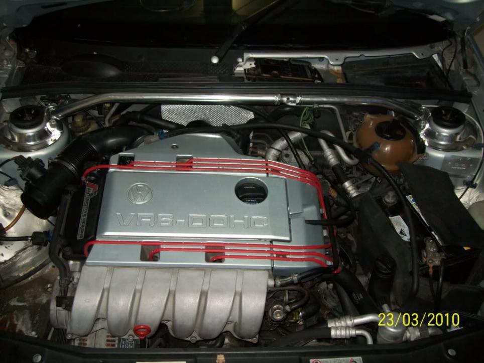

                        HAH44 update
                        LATEST NEWS- HAH44- is up and running- sounds so sweet-we are soooo happy.
                        Jmac came last night and worked his magic- found a wire on the ECU was broken, hence she wasn't talking to Jmac's computer, fixed and talking.
                        Fitted new MAF, new Intake boot, changed activated charcoal valve, changed the coolant sensor which was sending a reading of -50* and sorted out a few other bits.Jmac is coming back next wednesday to work some more of his magic to get her perfect- BIG BIG THANKS Jimmy- the only person we will ever let work on HAH44.
                        The GREAT NEWS is we will definitely be there on DYNO day with HAH44 (Annie) she will still have her original bonnet and guard, so if anyone wants to sign her they can on that day, before we replace parts and put her in for a respray.Then parts will go on his garage wall.
