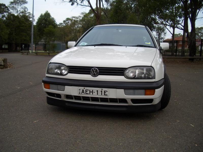

    Before:

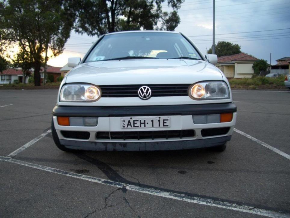

    After:

    thanks for sharing that Ray! oooohhh it looks so much better!
    i reckon it won't affect the light output though
    btw looks lovely with the eurolip and would be lovely DIY the badge with black!

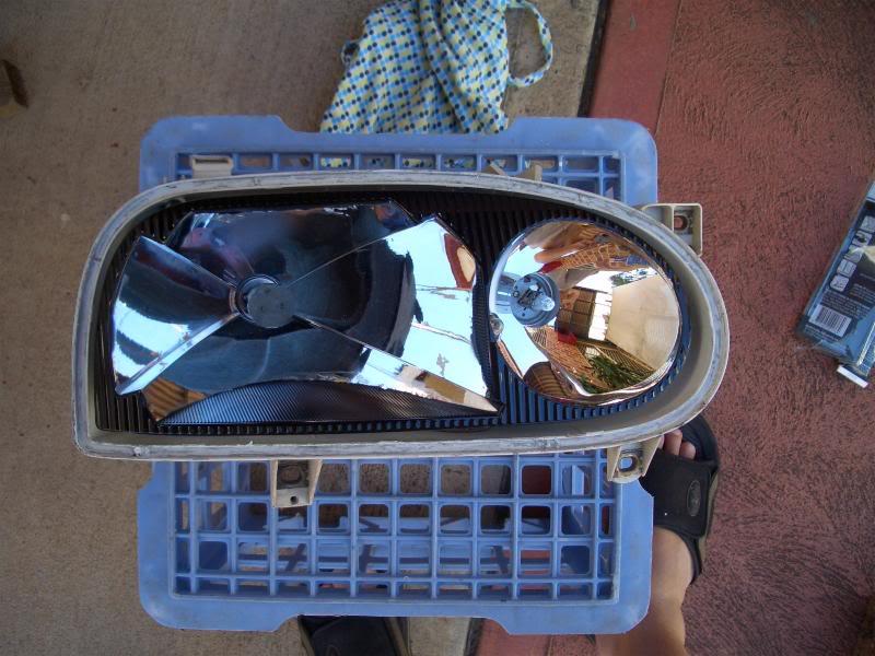

        hey mate what did you use to colour it black ? texter than it will eventually fade off , and sometimes come of in sections after a while if you use silicon due to the gasses released when curing. ive had this done to my car for over 2yrs. what you wanna do is paint them ( but thats hard ) but nothing will really stick to the chrome. ive sanded my chrome on the outside back to the plastic and you can get better adhesion.

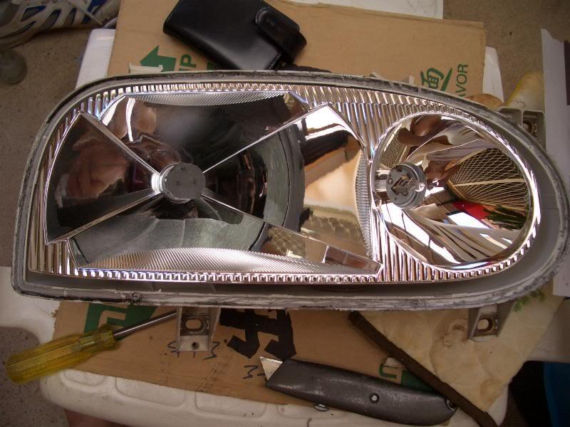

                I pretty much painted it the way I would paint another part of a car - (plastic) primer, 2-3 coats of matte black, then a clear coat. A big bother to mask the reflective parts - they would peel if your masking tape was too sticky - so I used glad-wrap to cover most bits. There will be overspray, and some parts would be missed, so I used touch-up paint to cover up the parts I missed out, and acetone to get rid of the overspray. Works a charm.
