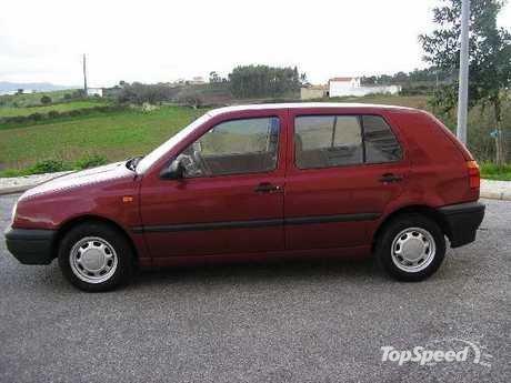

    Hi guys I really like these VW wheels, or ones very much like them
    were they usually on MK3 golfs? mine is a 1998 and has a star pattern but I love these types. I am in WA, any suggestions, on where to get them or what they are?
    Thanks!.

      I'd say try a local wreckers or something because steel wheels are pretty common. There's a heap out there, you might even like some of the mk4 steelies!
      Alternatively, put up a Wanted advertisement in the wanted section and see if anyone has any for sale.
        the most common and close style to what you showed in the first link are mk3 CL steel wheels, 14x6's
        hope that helps
        dom
          do you have a Vr6?
          if so look out for a set of mk 4 or new beetle steel wheels, the ones you posted are 4 stud, and the Vr6 is 5 stud.
          if you dont have a VR6, just look out for a set of standard mk 3 or mk 2 wheels (the ones you first posted came standard on aussie delievered mk 2 gti's)
            these wheels are from a mk2 golf gti. they came standard with aussie delivered models and are notable by their round holes.
            these wheels are from US spec golf mk3s. The australian MK3s have triangulated holes and are similar in style to the MK2 wheels. I think it'd be pretty rare to find a set of these wheels in australia.
            both are 6jx14"
            oh btw, they will only fit on non-vr6 mk3s, mk2s and mk1s.
