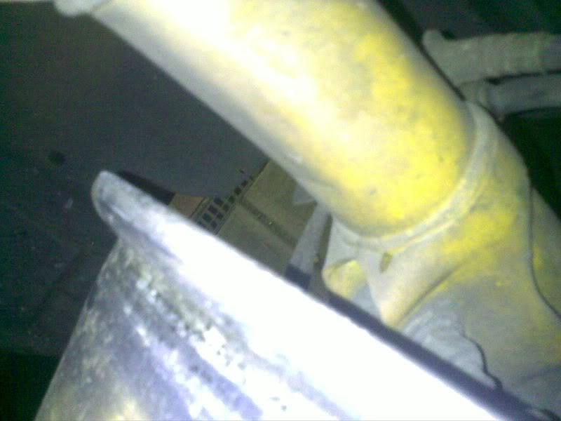

                        well, i test fit the 7.5 on the front of mums VR6, and as you can see its got heaps of clearance, thats with ET50, around 20mm of clearance between the rim and the strut
                        dom
