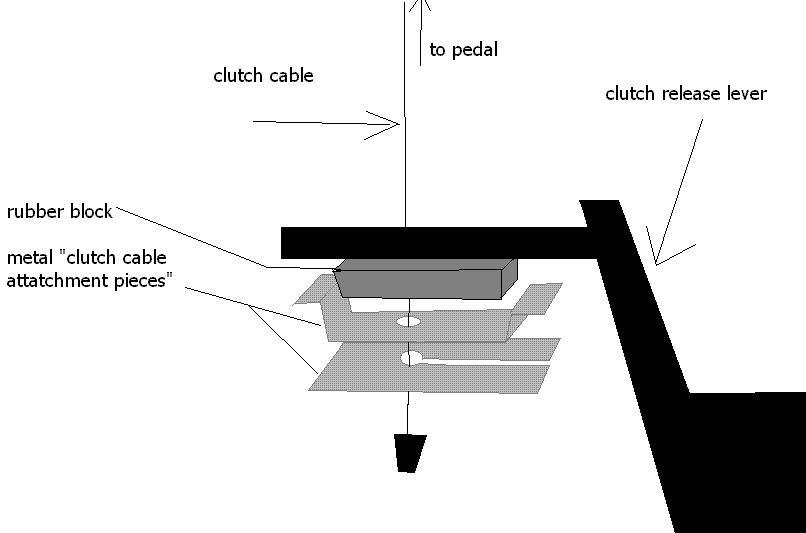

    Worst problem last night. Just as I was pulling into my driveway, the clutch snapped to the floor and fluid started spilling out from underneath the car...
    see below
    the two metal bits are gaawwn! as i was turning around they just flung off making the clutch release lever swing out, whack the gearbox end cap off and transmission fluid was spilling everywhere. after the initial "wtf" cooling off period, i jacked up the car to find all this out. i thought the clutch cable had snapped. lol
    anyway i was just wondering if anyone has had to replace this themselves and how easy it is?
    I have the bentley's book (it's awesome) but it says i need to use an engine sling to pull the clutch release pedal up so i can restring the cable back into it... is it really that hard?

      Something very similar happened to mine and my brothers Golf, the're both 2.0, the retaining clip which holds the metal ball on the end of the cable gives out..They cost about $10 from a dealer and take 30secs to fit. From under neath,Just use some pliers to hold the metal ball on the end of the clutch cable, push up then pull down sharply with a little force, this should release enough lenghth for the clip and the rubber block to go on. I'm not sure why your clutch fork swung around as I didn't encounter any of these problems. But as for the clip...cheap easy fix. Of course I drove 30kms in 3rd gear after mine broke at 2am and i may or may not have run a few red lights in order to reach my destination without stopping.

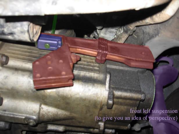

                didn't completely solve the issue.
                the cable is attached - just used the jack to raise the release lever (red) and re-insert the cable (green) so i could put the newly aquired "clutch parts kit" on (blue) (for reference it has a part number of VW-1H0798303A)

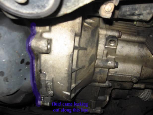

                my next problem is that when I tried to top up the fluid, it just started pouring out this gap i found between the clutch and the transmission (i think...)
                i'm thinking that the reason for the end cap coming off was because something inside the transmission broke (please god i hope not!!!) because on taking a second look, the clutch release lever doesn't actually seems to touch the end cap even when it swings past it...
                here's another pic...
                I am hoping it is just something simple. It looks as if there is a thin metal spacer where the oil was coming out and when I take a closer look, it seems that the holes in this spacer are not in line with the other holes. (whether or not these holes are just guides or whether they are supposed to have bolts in them, I am unsure)
                Just at first glance, does anyone know what the problem could be?

                    You are pouring the fluid in the wrong place man.
                    You are pouring it in the inspection / timing hole, all over your clutch. Thats why it is coming out of the bottom. That plate just covers the clutch.
                    You take the speedo cable or speed sensor unit out of the gearbox and pour it in that hole Its towards the back of the gearbox and should have 3 wires going to the sensor.
