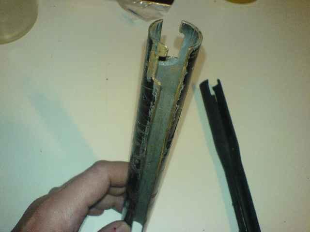

              Dont purchase a new plastic one from VW! Those things are useless and break very easily. Get a proper metal version..
              Dub Addiction is working on having some produced locally in the not too distant future but we have nothing to offer right now unfortunately!
              I did make one myself though out of an old piece of metal tube i had at home. Crude but effective (you can see the broken plastic one in the background)
