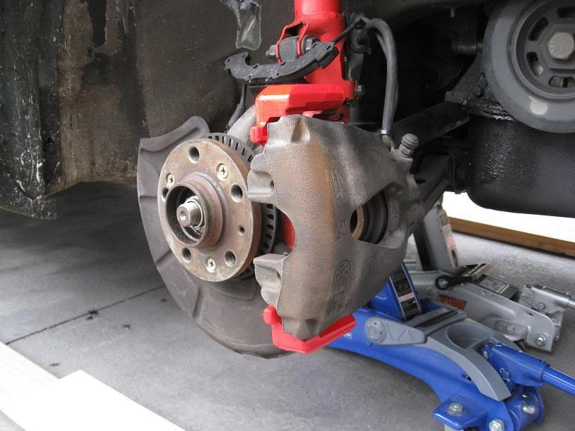

        If you've got calipers that look like this, they're 288mm brakes.
        For a brake change, you need the caliper, carrier, brake disc, brake pads obviously and some time and knowledge. Loon helped me out with my brake upgrade and I think it cost me 250 with his help and a swap of parts.

                Oops, I just realised the pic didn't upload in my other message. Here you go
                  this is what a 288 looks like.
                  take a front wheel off and have a look. the 280s have slight lower offset wheel mounting face. (the surface with the holes for the wheel bolts sticks out noticable more)
