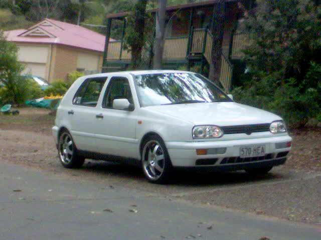

                      My 97, has oval indictors of course...i like them better cause i'm fitting mk4 clear ones. I fitted vr6 tails too, my bumper tops are body coloured and my side skirts are black. My third brake light is inside behind the glass and there are fog light wires but nothing to plug them in to. Also the warning chimes are a lot less annoying than the ones in my brothers 95 GL. I've got rear head rests too, he doesnt.. Heres a (poor mobile phone quality) pic of my car..

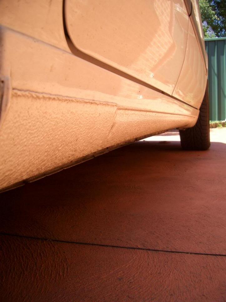

                              That's really strange, as the bottom of the side of my car isn't smooth in the way that you think a car without side skirts would like (does that make sense?)
                              Here's a pic anyway:
