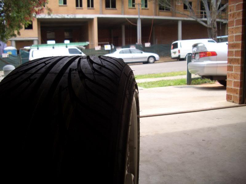

    My 205/40R16 (Nankang NS2) over 8":
    If you go for 195, get 195/40R16. They exist but they are a rare size and may cost a fortune if there are any. Otherwise, just get 205/40R16. 195/45R16 will actually provide less clearance than a 205/40R16 since the sidewall is taller.
