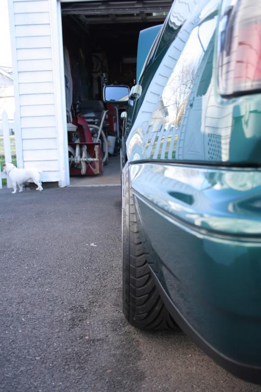

The fronts are equivalent to 16x8" ET20, and that has just a bit of poke with very little camber. ET30 should be just a little inside the guard. 195 tyres will mean less rubbing when attempting full-lock. Rears on this car is 16x9" ET11. ET17 would just mean 6mm less poke, which will still make it poke, just less. Don't know what the tyre sizes are for this pic, sorry:

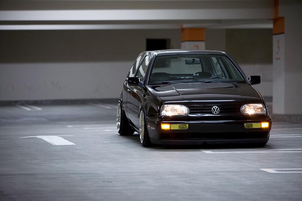

16x8" ET32 on the fronts:

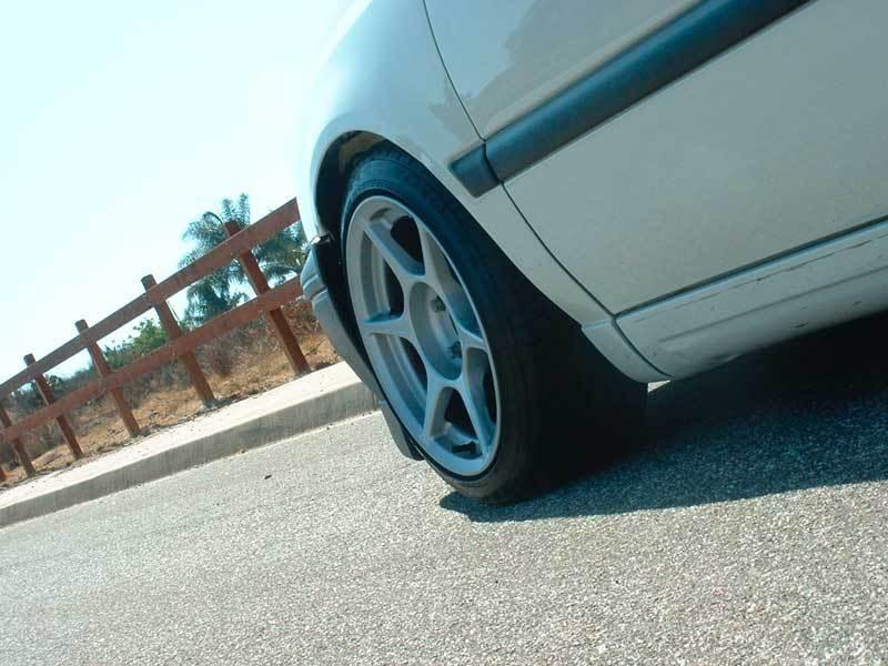

16x9" ET18 with 205/40R16 tyres. Camber isn't that large here, it's the angle of the shot:

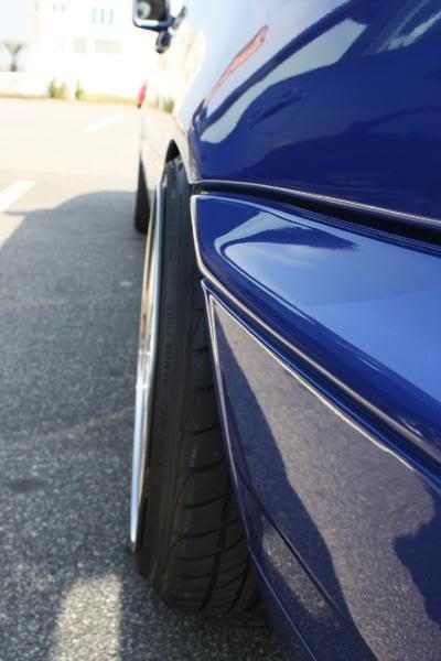

16x9" ET20 with 215/40R16 tyres:
