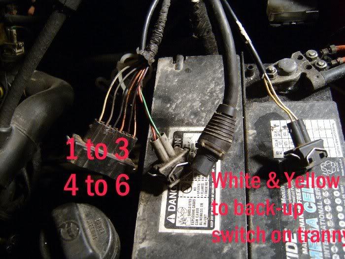

      heres what i found. gota jump these wires.
        Thanks guys I`m gonna try that now.
        Yeah I could remove the whole loom Gav, but its a dash out job and I dont really want to.
          Thanks Josh, that was a good link.
          None of those suggestions worked, in the end I simply jumpered a wire from the ignition to the relay and car starts sweet as.
