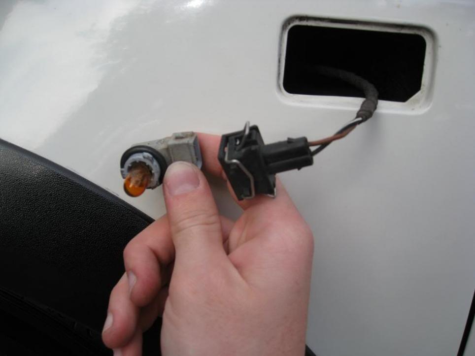

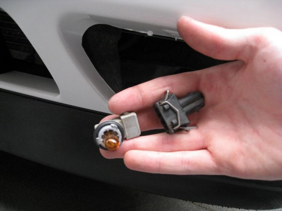

    Ok so. It turns out the side repeater plugs:
    ...fit into the front indicator plugs!

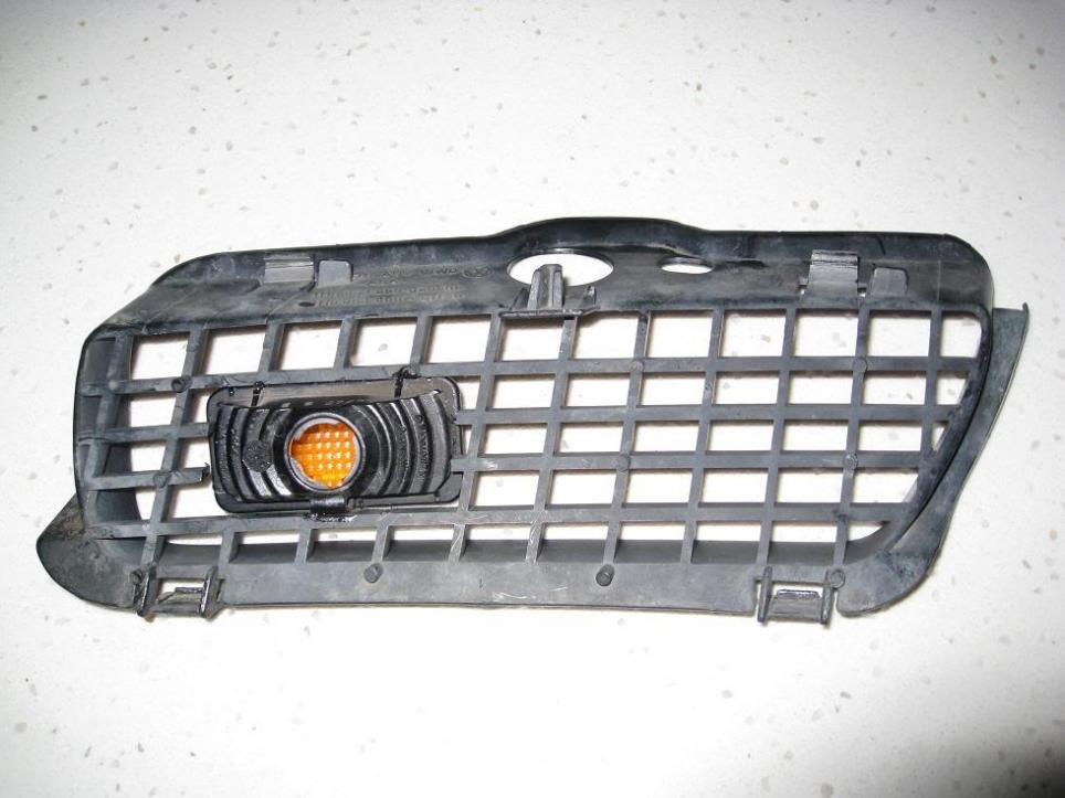

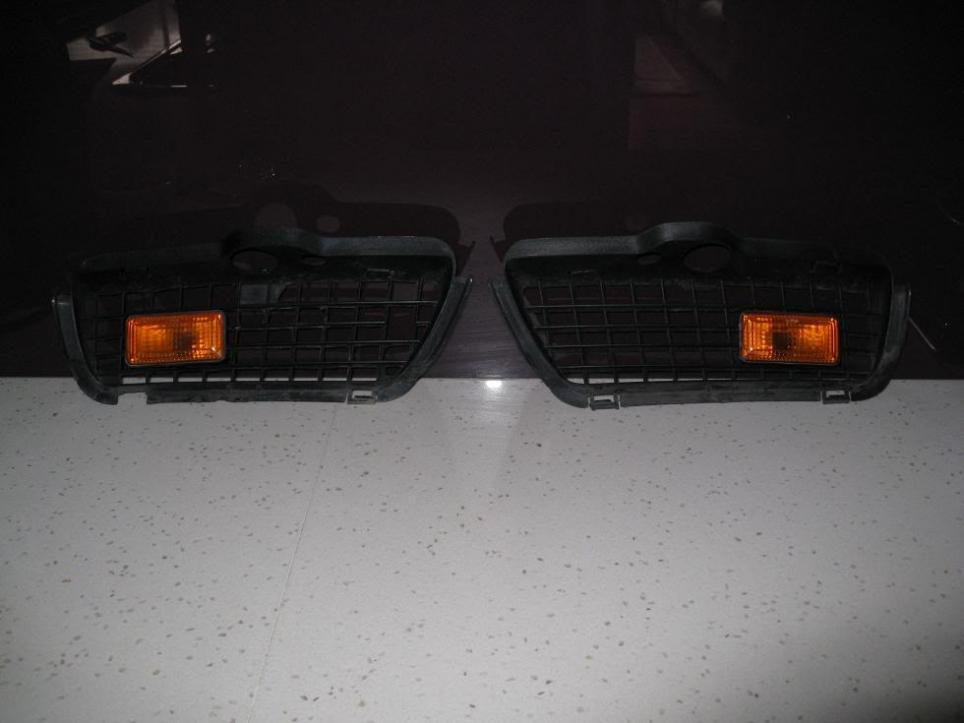

    With this mod I used my OEM orange side repeaters and cut them into the lower airducts, sticking them in place. Like so(sorry, dark pic):

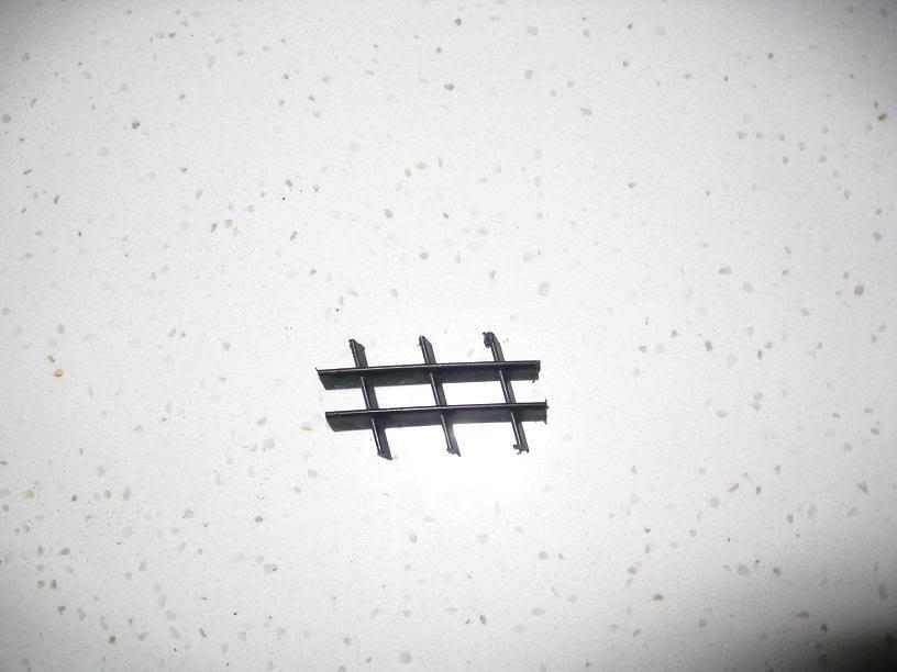

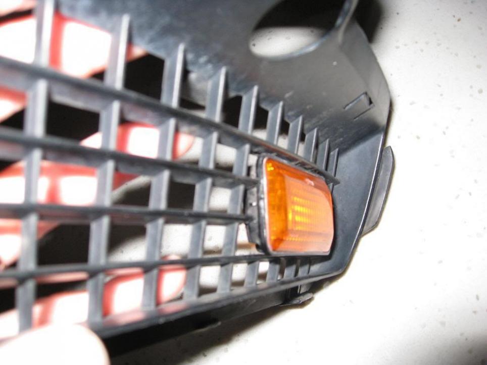

    To do this, I used a small precision saw and cut some of the black mesh out of the mesh duct. This is how much I cut:
    When cutting this, you'll see in the next picture that I didn't cut all of the HORIZONTAL mesh out (the two black lines of mesh on each side) because it would have left an open gap behind the indicator. I cut about halfway:
    You'll notice that they fit perfectly into the gap of the mesh that was cut out (I love mk3's ) and seeing as I angled them forward so they face straight ahead, I glued them on an angle to the mesh duct. This is the glue I used (well...the packaging of ); it comes with a primer texta so you get the best grip on both plastics. Make sure you apply the primer to both sides, but the glue only to one:

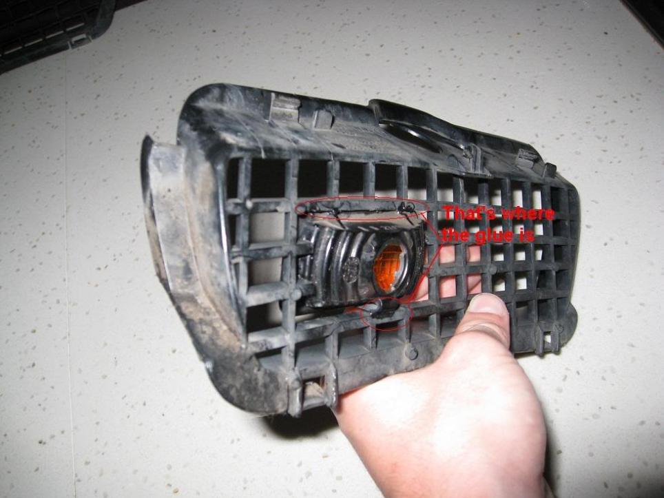

    It's a bit hard to explain, so hopefully the pictures will clear things up...what I did was glue the bottom tab of the side repeater (which sits at the bottom, don't get that mixed up!) to glue on the bottom mesh part, and I glued the top of the side repeater (this time the whole top, not just a tab or anything) to the top mesh part:
    Let that sit for a few hours, and vwah-la (i don't care how it's spelt!)

                      Up close shots:
                      Not as bright as previous (but not as dull as in the second pics) but it looks good when the lights aren't flashing!
