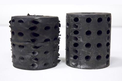

    $199 had it delivered to my door in a couple of days, and sourcing the instructions for installation on the net, they went into my car on Saturday (sorry, no pics!) It basically involved getting the car on small ramps, or blocks of timber to get the jack under (too low otherwise ), removing the top bolts on the motor mounts, jacking the engine up carefully and I do say carefully as jacking up from the sump can cause oil pick up problems etc, then you undo more bolts scattered around the mounts and look in amazement at what shocking mounts you had in there before!
    Mine actually did look like the one on the left. They were just so squishy. So the new mounts went in without a fuss.
