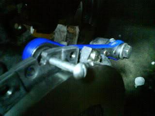

          Ull need something to lock the flywheel/pressure plate when torquing up the bolts. I used two bolts and a rachet socket wrench to lock it in place:
