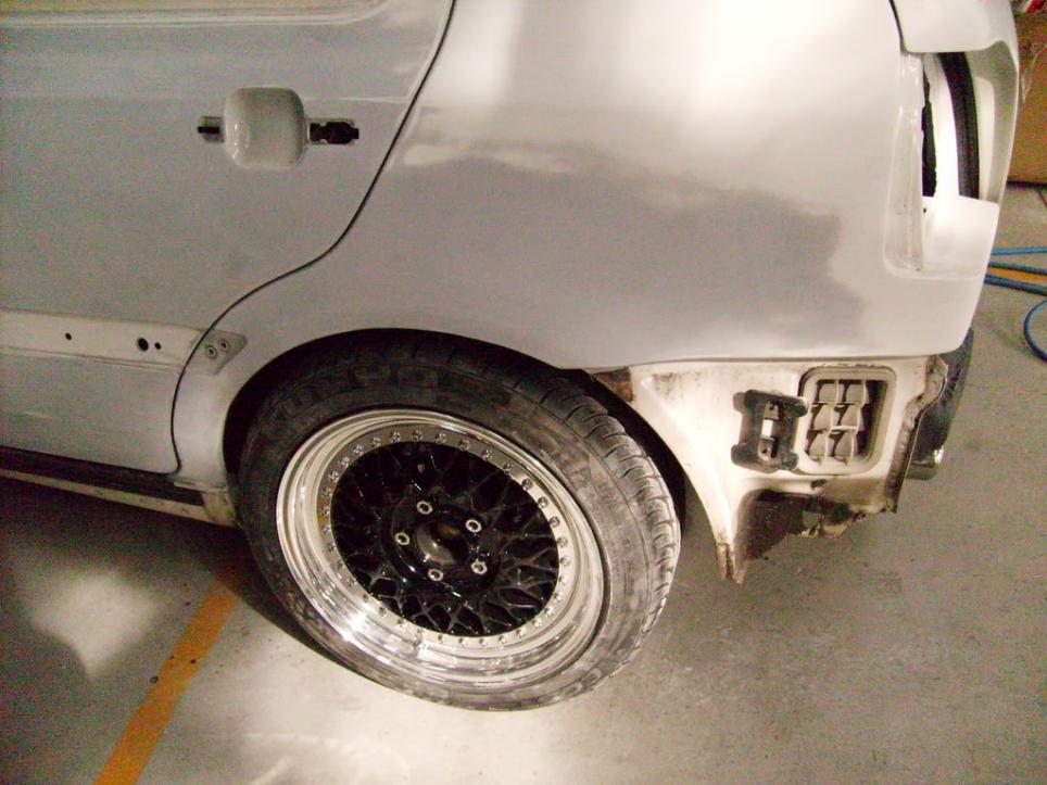

            shame they is 4 stud.......
            nice wheels but

              • #22
                Lovely rims!
                Originally posted by Joe88
                Now that is dish!
                You could bake a cake in that dish....
                  nice wheels but
                  I think that's just a random pic of the Work Nezarts. Alex has a set in 5x100.
                  Present: Mk3 Golf variant.
                  • #24
                    oh. now im interested.....
                          Yes, well done ray twas a random google find lol, but thats exactly them . . . already had two expressions of interest
