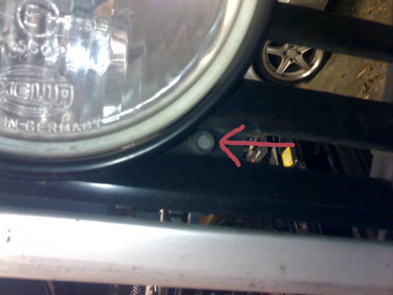

    hey guys just picked up a new grille, now got a problem,
    i have gone to unscrew the two screws holding the inner spotlights in place, then theres a third screw or something holding it in place... do you guys know what i mean ? .. all i want to do is swap the grille over and i cant take out the damn lights.. any help is appreciated thank you

      yeah and theres another one on the bottom inner (near the VW badge) do you know what i mean ?

            the grille is off the car guys.. im not that dumb...... but theres two screws and on like false screw.. but its holding the light in still

              don't worry, i know exactly what you mean...
              some mk2 grills only have 2 adjusting screws on each light and one main pivot.....the bottom one on the inside(closest to badge) is just a fixed pivot.

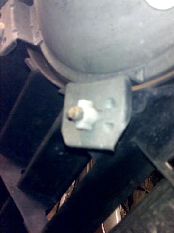

              My GTI has 3 screws in each, and my mk2 Driver has 2 and a fixed pivot on the 3rd.
              this little bugger isn't threaded and has no screw head.
              even those with screws can be popped out so you dont bugger your set adjustment. the heads of the scres are ball shaped and fit into a ball socket set up...
              so as for your 3rd mount....give it a good push from the outside face and it will pop out.....

              this one isn't a screw...pop it thru with a punch or an old screw driver, don't stab yourself!
              sorry 'bout the blur... the bottom white part isn't threaded, nor is the bit that goes thru it....but the ball will pop out of the socket when u push it .takes a bit of force tho.....
