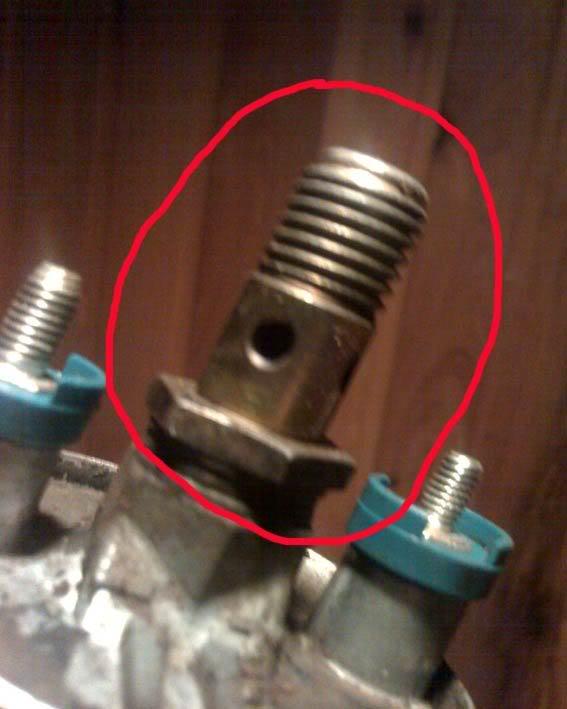

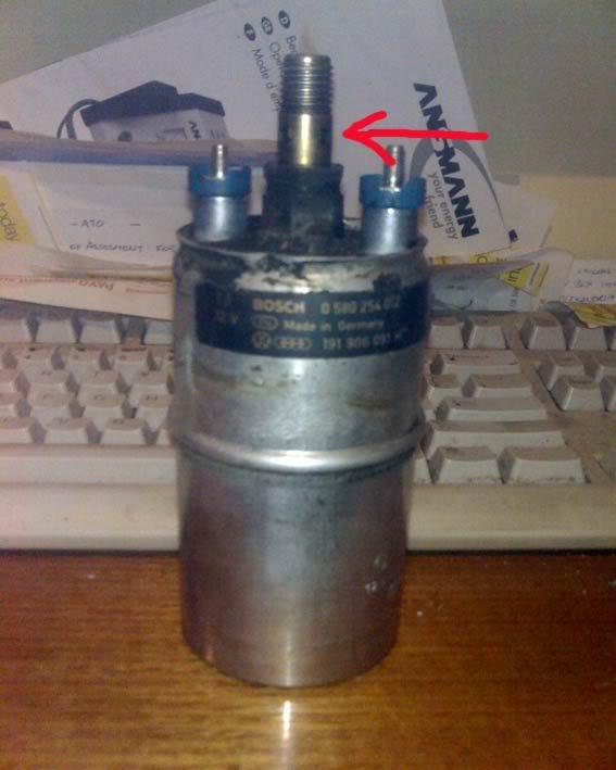

                      We were looking at the pump on a kjet car today and like Jimmy says there is a reduced in the end of it. And it was all clogged with cw@p.
                      We just drilled the middle out, so it flows good now
                      Some year models had the filter but some did not. I think it was an experiment by VW and is not really needed.

                        Yeah i agree Loon but there is a ball and spring in her too to keep the pressure residual for hot starts

                          Just screws out...Keep em if you ever change a pump!
                          that part on lists says part number 0580 254 021
                          but that part number is "the pump" its self with that in the end....
                          please note.....the label on the pump pictured has wrong part number on sticker....
                          says 012 on end, and on body last 3 digits are 021.
                          Also Jayjay...get a specific Presure guage if you can, K-jet runs very high pressure!!! more than other inj systems!
