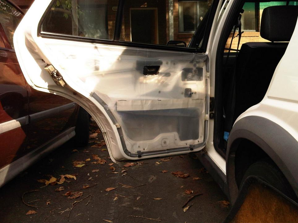

                    Had this same problem and fixed it by redoing the plastic membrane between the door and door card. With old age, the plastic shrinks and pulls away from the seal, allowing any water that hits the plastic to drain inside the car, rather than into the bottom of the door and out the drain holes.
                    First step is to check that the drain holes are actually clear and allow water to pass through. If they are, then the problem will most likely be the water running down the window into the door, hitting the plastic membrane and draining into the car.
                    New window scrapers also help limit the amount of water getting in, as the older rubber becomes hard and moves away from the window allowing any water on the window to run down into the door.
                    What you need:
                    • Phillips Head screwdrivers to take the, inside door handle, window winder and door card off.
                    • A roll of plastic sheeting
                    • Gaffa/Duct Tape
                    • Scissors/Knife
                    1. Remove the long door handle (2 x screws under the cover), remove bracket on door handle latch (slides to one side then pulls off), window winder (1 x screw under the cover), pry up the bracket holding the lock in place, pop lock out from door card, remove door card (4 x screws around the edges), lift up and out off braces.
                    2. Inspect plastic membrane for tears or wet spots (helps to run a hose on the window to see where the water is coming in).
                    3. Remove plastic membrane, use it to trace out a new one on the plastic roll you have and cut it out (allow for a bit of leeway for ashtrays, etc in the door card when cutting the new sheet, as they will push against the plastic and may tear it or pull it away from the door).
                    4. Now, the most important part is, cut a second piece of plastic as wide as the hole on the inside of the door and high enough that it rests below the bottom edge of the hole in the door, tape it to the door-side of the large plastic sheet you previously traced out, but just above where the hole in the door starts. The 2nd sheet will divert any water that gets into the door straight to the drain holes and away from the door cards
                    5. Tape the new sheet to the door, starting from the bottom-up, and trim any excess off as you go up, to keep it straight and fairly tight (avoid creating creases which will funnel water).
                    6. Angle the second sheet you taped to the inside, down into the bottom of the door, keeping it all straight and tight, cut holes for the door handle, window winder, etc (you can reinforce these by putting tape over the spot then cutting through the tape).
                    7. Finish taping it up, trim any excess tape that shows carefully with a knife, put everything back on and you're done.
                    Here's a picture from when I did mine. I initially did it without the second sheet, but water eventually worked its way through the tape, onto the door card and into the car. The 2nd sheet angled down to the bottom of the door completely fixed it.
