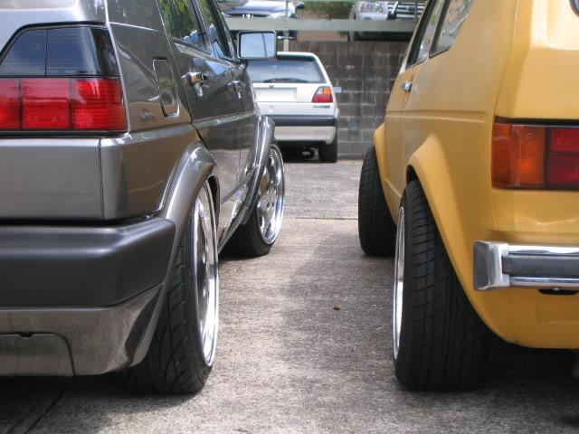

My mum's Mk2 has 17x7.5 BBS RX ET 35 & 205/40R 17 tyre's
Modified AVO/KONI height, compression & rebound adjustable coilover's & with a full load it barely scrub's and it's low! (can go much lower but it's mum's car!) At it's current height is where the suspension work's best with alittle preload on the spring's!
I have 15x7 Ronal's with ET 25 with 195/50R 15 tyre's on my Mk1 and I can't put anymore than 2 people in at one time and it scrub's like a bastard!
front and rear are wider but the front is like 3cm wider where as the rear is not so noticable.that jetta above has front arches on the rear as well thats why they look so fat
