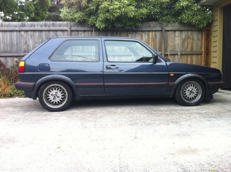

    you tool jarred
    anyway there in and AWESOME!!!!!
    i lowered it so the wheel arch is flush with the tyre, could go heaps lower though.
    still need to do some fine adjusting on camber and corner heights.
    but they are amazing, nice and firm yet surprisingly comfortable.
    and the thing that amazed me most..... its almost dead flat through corners!!
    raise the front or lower the rear???

      lower rear looks soickkk

        • #49
          How full was the fuel tank in that pic?
          Welcome to the chin hitting, ass dragging club

          • #50
            Hahaha..
            Tank is about 3/4 full,
            I'm waiting till I have to leave the house, I'm surrounded by speedhumps!!!!

            • #51
              If anything id raise it a bit.
              • #52
                I honestly reckon raise the front a pooftenth.
                still needs to have a bit of rake, but at the end of the day, you car does look very purposeful (semi motorsport), which I think is a cool look for the car.
                I'd lower it to around about where the front control arms are level, and raise the rear about 10mm from that.
                • #53
                  The control arms were level with the other shocks in. This setup is another 20-30mm lower.
                  When I was in the UK, I had a chat to a guy there who races mk2's.. He's was just a tad lower than this, and he said having the control arms level, barely makes any difference. Forgotten his name, but he's apparently one of the go to guys for setting up mk2's for racing.
                  having it this low, the car handles heaps better than ever before, and speedhumps are becoming a problem
                  I'll raise the front 5mm, and see how we go.

                  • #54
                    raised the front 2 turns (8mm)

                    • #55
                      Don't forget, give it a week or two to settle before deciding on your 'final' heigh and get an alignment.

                          • #58
                            Cheers guys,
                            I'll raise it a little then.
