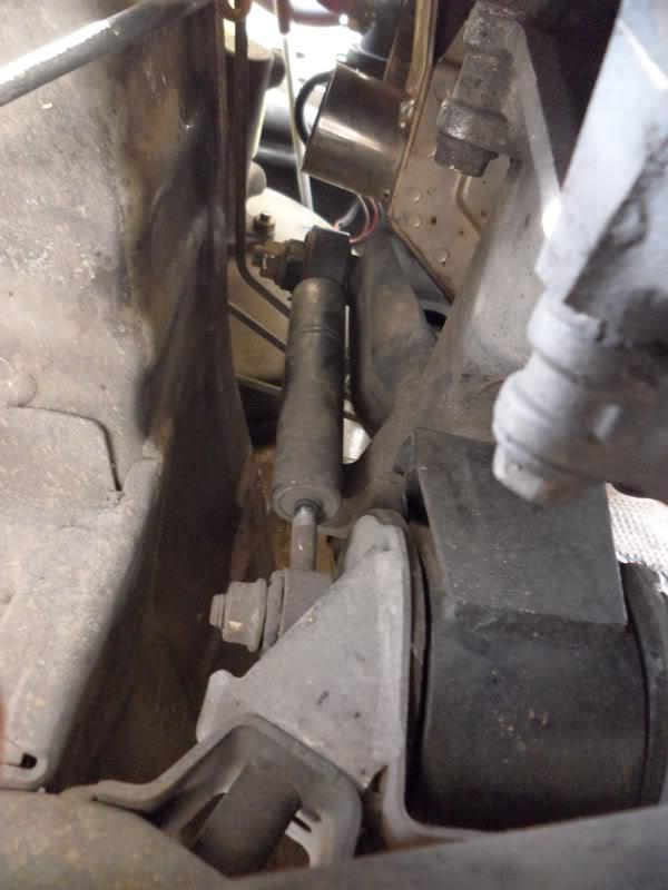

    Driving the MK2 around latly, I seem to notice, what feel likes, increasing amounts of engine movement.
    Is a 4 door 92 MK2 with a 2E engine, which has had the front and rear transmission mounts replaced.
    Had a look at the rear engine mount set-up and confused myself in the process
    *Image is taken looking up at the rear (right/drivers side) engine mount area
    I cant say Ive seen a set-up like that before, a gas strut of some-sort 'assisting' the non hydraulic (assuming its non hydraulic) engine mount?
    Query 1 : Is that set-up, with the strut, OEM?
    Query 2 : Does that appear to be a Non hydraulic engine mount?
    Query 3 : Any suggestion on where/what engine mounts to buy (OEM, or stiffer)
    Any input welcome

    Hmmm, ok, well for starters, if it truly is a 2E 2ltr (with the aluminium rocker cover), then its had an engine conversion at some stage coz mk2's never came with a 2.0ltr 8v engine anywhere... but you probably know that already.
    I have seen that mount setup before but have only come across it in the mk3/4 Cabriolet's from memory???
    You should be able to fit a standard golf 2/3 rear engine mount as they are the same part for the 1.8 and 2.0 (except some cabrio's of course) and the brackets are the same too i believe.
    Chime in anyone if i'm wrong...
      Thank-you for the input, much appreciated.
      Most deffinantly is a 2E (with the alloy MK3 rocker cover), and according to the log books, its been in there since 1992
      Going off feedback on a Pommy forum, ETKA referance's a similar set-up, with the damper, on PL and KR valvers.
      I think the MK3 (2.0L) rear mounts are hydraulic whilst MK2's used a combination of hydraulic and non-hydraulic rubber mounts.
      I beleive the rear mount in my car currently, is the non-hydraulic type which uses differant brackets.
      Hydro mounts vertically, whilst the non hydraulic mount sits horizontal with the bolt going through it.
      But I could be completely wrong too.
      EDIT: ^^ And I was
      Your right, I can swap over a later hydraulic mount set-up by removing 1 of the brackets that allows the use of a non hydraulic mount.
