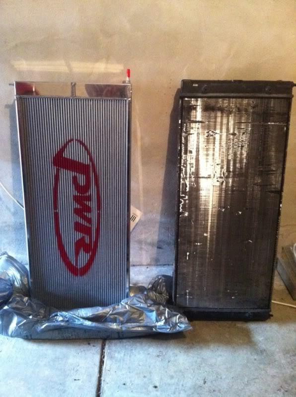

                    get one of these bad boys... $957 from PWR
                      Saw that in your thread. Very nice!
                      Too rich for me though, the radiator is worth more than the car
