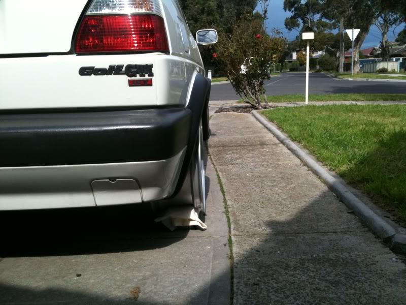

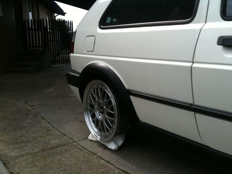

                                With, a 5mm spacer the inner lip is only 3mm from the strut. Wil definately have to reverse mount them, and get the rear guards rolled majorly, but I don't mind.
