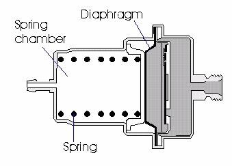

        FUEL ACCUMULATOR
        (next to the main pump on a mk2)
        It accumulates fuel......lol.
        and it's the first part in the fuel system after the pump.
        Its first job is to help smooth out any pulses in the flow of the fuel, this is achieved by passing the fuel through a series of baffles and into a chamber giving it smoth flow. Its other role is to maintain pressure within the system when the fuel pump has been switched off.
        This is achieved by the accumulator spring and diaphragm pushing against the fuel.
        When engine is running the diaphragm will be against its stop within the spring's chamber. When the engine is stopped and the non return valves close the spring pressure against the diaphragm will maintain the pressure and stop any seepage.
        in most data books for this system it is shown that the critical time for maintaining these pressures is between 5 and 20 minutes. After a fang when the engine is switched off the under bonnet temperature increases, causing the fuel in the lines to heat up....this will usually make fuel evaporate.....but maintaining the pressure fixes this problem and will let it start when its been standing with a hot engine.
        Quite often the problem with hot start issues, though not always.

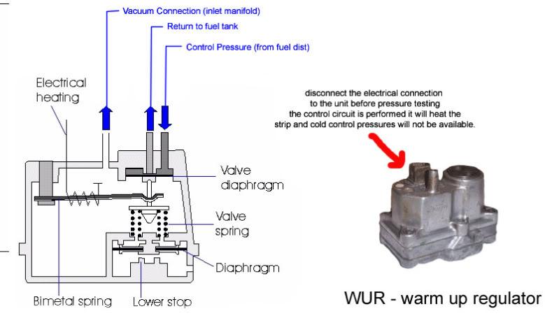

                  The Warm-up-Regulator ......
                  This thing controls the amount of fuel delivered to the engine during it's warm-up period. The pressure acting upon the top of the control plunger varies depending on the engine temperature and provides an effective method of enrichment.
                  The control pressure is tapped off from the primary pressure circuit in the metering head's lower chamber through a tiny restrictive hole which gives it the ability to differentiate between the two pressures. A flexible pipe then connects the control plunger gallery to the warm-up-regulator and returns back to the metering head to a connection next to the primary pressure regulator's transfer valve. This valve is in the circuit to close the fuel from the control circuit when the engine is off, avoiding the total loss of system pressure while the engine is stationary.
                  The internals of the warm-up-regulator are quite simple comprising an inlet and outlet port, a stainless steel shim, a bi-metalic heated strip and a spring.
                  The input to the warm-up-regulator flows into a small chamber in the top of the unit, its return is through a small drilling and back to the metering head. By controlling this return flow it will cause a change in pressure acting on the top of the control plunger. With a cold engine the flow must be fairly free giving it a lower pressure. This will allow a higher lift of the plunger which in turn will enrich the mixture under these conditions. The free flow is obtained by the internal bi-metalic strip exerting a downward pressure on the spring which decreases the pressure acting upon the shim, this lower force allows the fuel to flow almost uninterrupted.
                  As the bi-metalic strip is heated, by either it's heater element or natural heat soak from the engine, the downward pressure acting on the spring is gradually decreased, increasing the force of the spring, which in turn increases the control pressure.
                  Typical cold engine control pressure will be as low as 1.0 bar increasing over approx. 10 minutes to around 3.5 bar. Some warm-up-regulators have a vacuum connection that will sense a drop in vacuum and lower the control pressure during these acceleration periods.
                  The voltage supply to the regulator is from the fuel pump relay, because if the ignition was on without the engine running, all enrichment would be removed as the bi-metalic strip would be heated prematurely and the driver would not benefit from the cold engine enrichment.
                  The two pipes that connect to the warm-up-regulator have different sized 'banjo unions' to avoid them being connected incorrectly. The control pressures quoted are as an example only and reference should be made to the technical data as these pressures can be specific to the part number located on the unit's housing.
                  This unit will have a resistance value of approximately 20 to 26 Ohms.
                  NOTE :- it is important to disconnect the electrical connection to the unit before any pressure testing on the control circuit is performed as this will prematurely heat the bi-metalic strip and cold control pressures will not be available.
