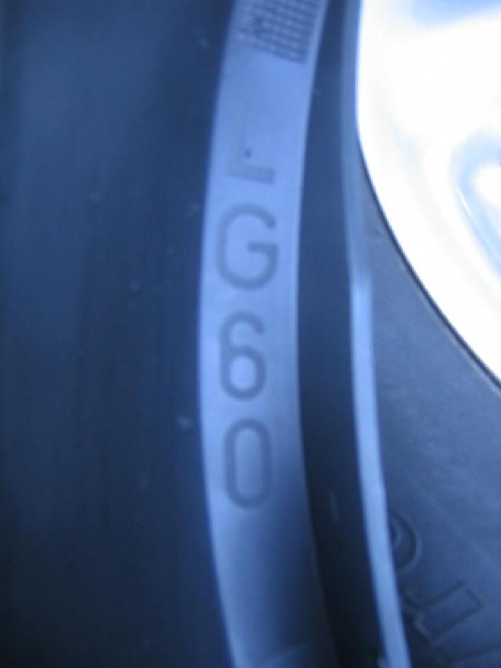

          Checked on ETKA and it looks to me like there is only one kind of G60 arch which fits 2 and 4 door. the part number ends in D for front and back.

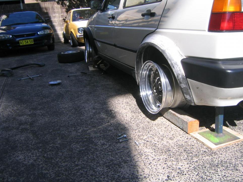

                How much wider are the rear flares of the G60 kit as apose to the standard flares?? 1cm? 2cm? Would it be possible to adapt the front flares to the rear arch?? i'm assuming I could?? . . . thanks . . .
                  You could adapt them if youwant killz, actually read of vortex lastnight someone did it. massive job though and you have to cut, heat and remould them in to the skirt line. His came out nice because he painted them, if you kept them black all the cuts would show.
                    the rears arent that much wider at all thats why i built my custom ones to run wide rear wheel, alas i never put them on my car and are off to some lucky fellas home

                    here is my set with front g60s

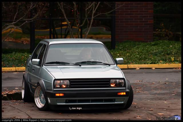

                      g60s front n back

                          yeh, that jetta is def a fav throughout all my internet scouring of mk2 jetta's! should see it from da rear!
