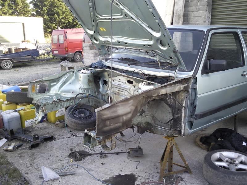

    Started out like this;
    Stripped!!

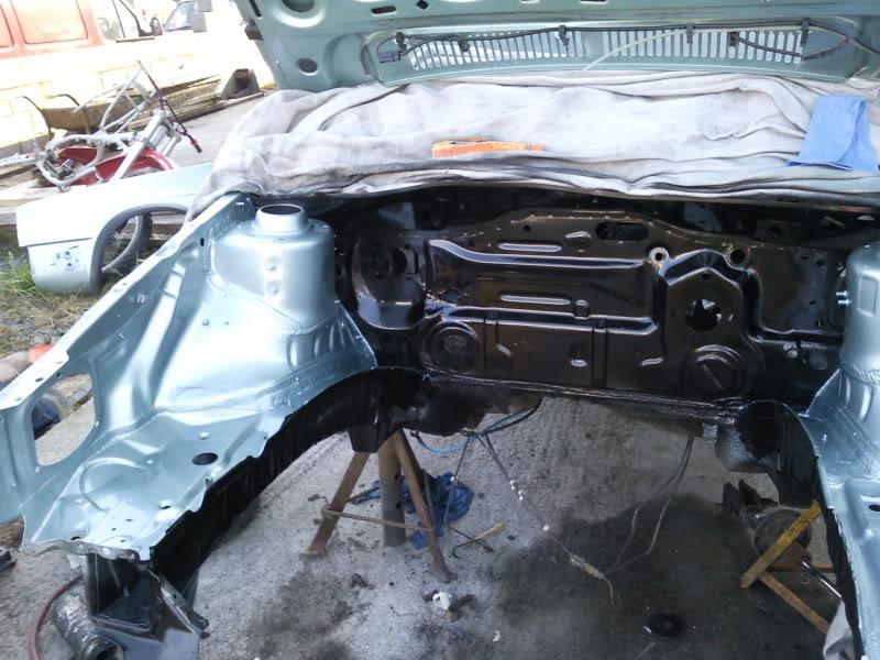

    Bay painted;

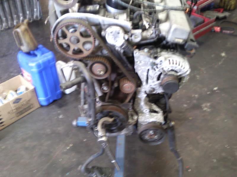

    Getting the APY lump ready;

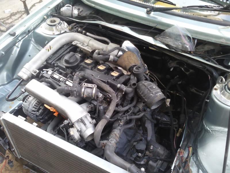

    Engine in;

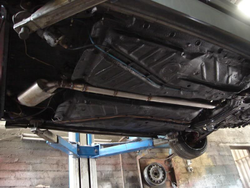

    Underneath all sealed and exhaust on. Powdercoated rear beam in too.

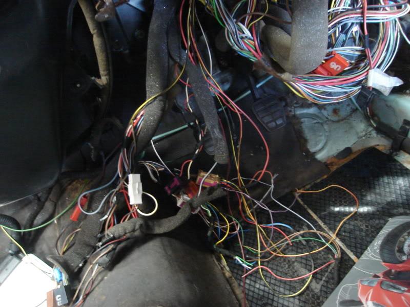

    Some of the wiring heartache!!

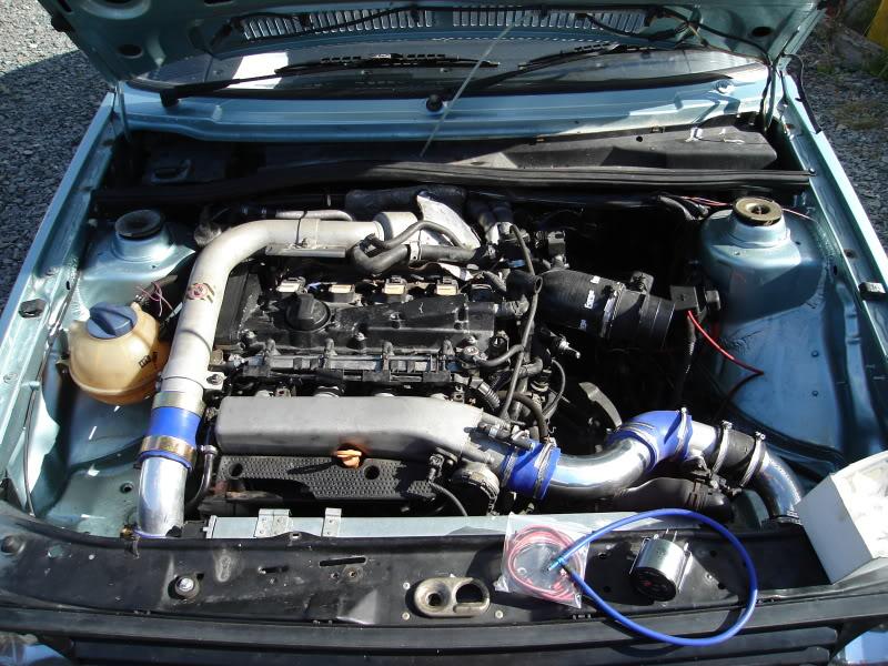

    Engine plumbed and running;

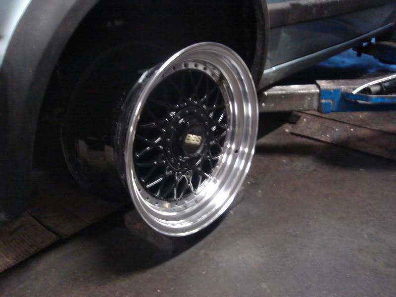

    Rm's split and polished;

    Bit of a spec;
    Engine
    APY out of a 00 S3 with 100k
    Forge turbo intake pipe

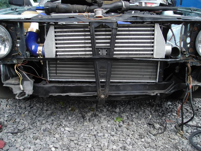

    Forge 100 series intercooler(pipework has to be tidied)
    o.e ecu with diagnostics working
    qpeng downpipe mated to unknown axle back
    02a CDA gearbox with quaife atb
    Vr6 fuel tank, pump and lines
    S2 calipers up front with new g60 discs
    mkiv rear calipers with new discs
    fully polybushed
    apex coilovers up front and koni shock/spring on the rear
    BBS rm's 15x8's all round.
    Ibiza cupra interior
    momo team 280mm
    vdo boost gauge
