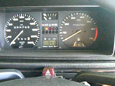

    When I first bought my MK2, for the first few months it would easily start by the 4-5th compression stroke, I really only needed to run the starter for a second for it to start.
    However over the last month I've noticed that it has become consistantly harder to start (from cold).
    When starting it I can either hold the starter on for 5 maybe 6 seconds and it will cough into life, or I can run the starter for 3-4 seconds, switch it off and then hit the ignition again when it'll literally start in less than a second.
    Heres a basic video of what I mean....
