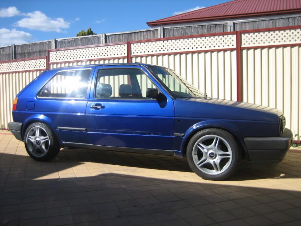

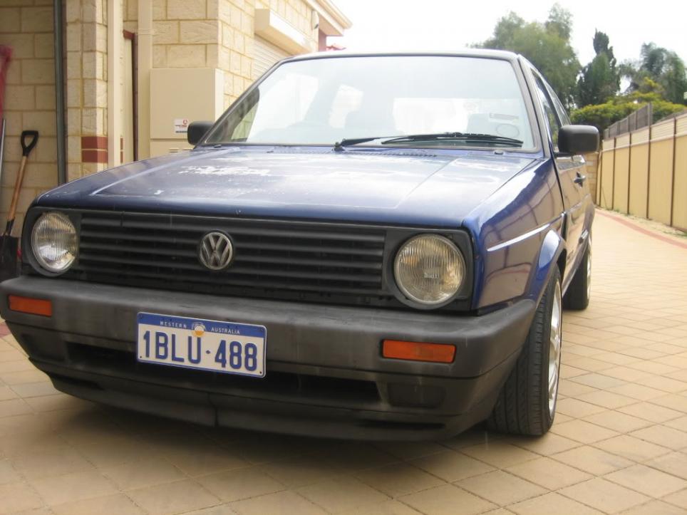

    The passenger door seems to be folded in, not quite sure why and the fender is dented. Pictures below. Maybe a panelbeater can fix this or try get a second door, if i can find one.

    but what can i say, what do you expect of and 1987 car and finally some pics.
