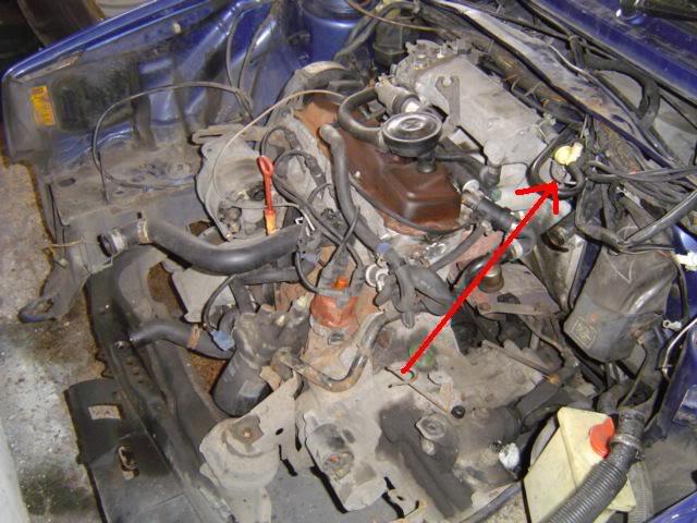

    I have a pod filter and no carbon canister on the 16V so I currently have the vacuum lines arranged like this;
    Question is, the MFA has a vacuum line for the MPG reading, but where do I tap that in to the vacuum circuit to get the correct reading?

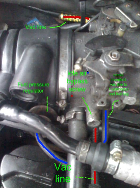

      Hit up google and got this, but it's 8V
      Mfa Mpg Vacuum Hose - VAGdrivers.net - sponsored by Alloy-Wheels.ie
        Thanks mate, I was a bit slack this weekend and have not googled it.
        There are (on mine at least) 2 outlets on the check valve. I have had them simply looped together. I have taken the vac line from the throttle body and relocated it to one of the spikes on the check valve (manifold side) to see if this will make a difference. It should get more vacuum, as it is off the manifold and not the TB.
