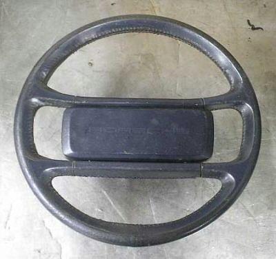

I was looking at either this style from a 1986 911;

After a bit of research. Porsche 924/944 wheels will fit straight on to either an early (pre '87) MK2 or MK1.
911 wheels have a bigger spline and won't fit. So the search is on for a brown 924/944 wheel.
