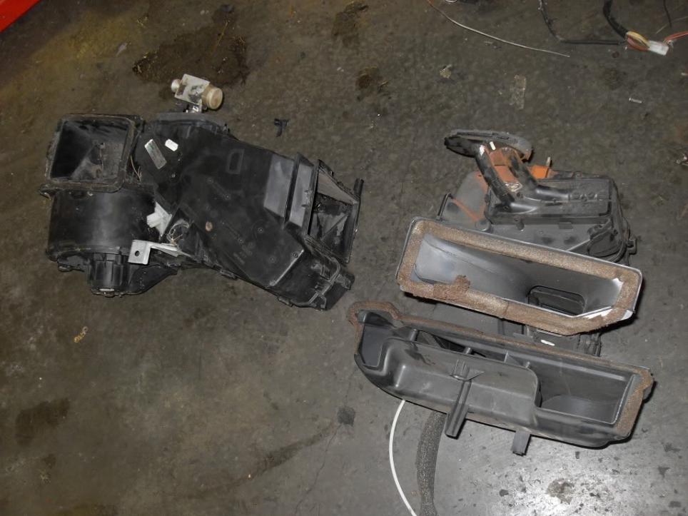

Mk2 Heaterbox removed from car
Note early type hose fittings
Split Apart like this

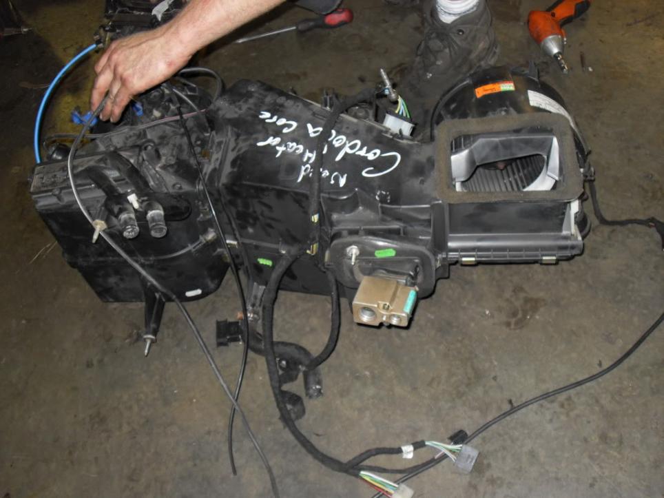

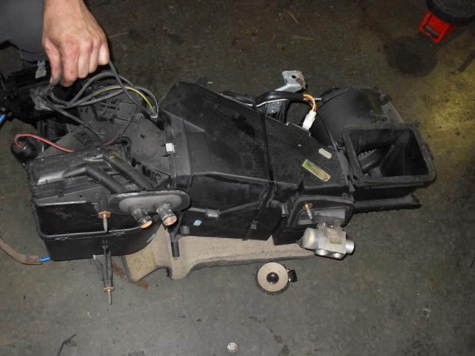

Reassemble with Mk2 centre section and SEAT Cordoba ac / fan section
Note later metal hose fittings
