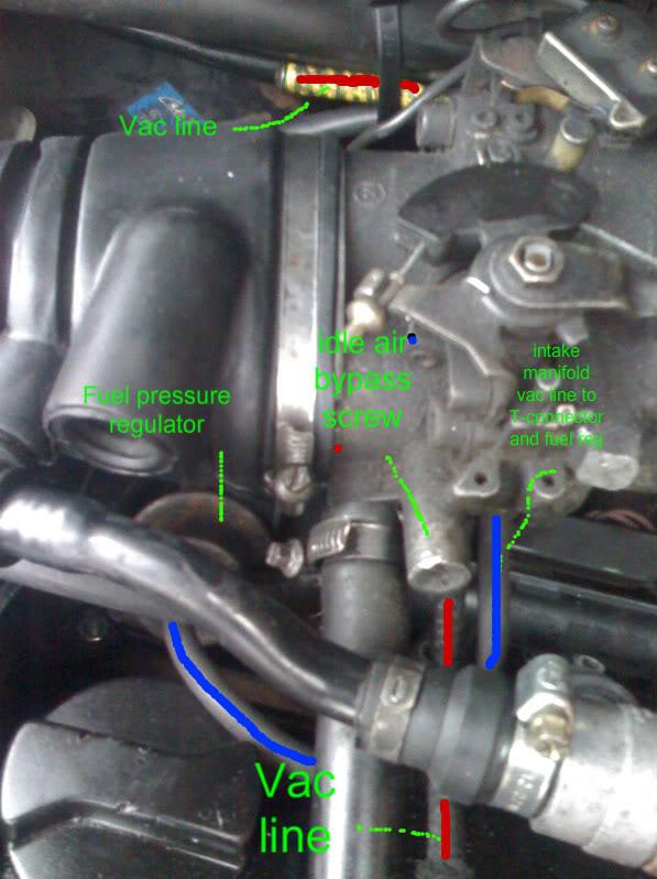

    On my car with mkii digifant and a pod, I have the fpr direct to the throttle body and the other hose is still conncted at the trottle body but has been cut and plugged. I'll try to find a pic.
      mikinoz... thanks, makes sense.. If you could find a pic that would be excellent.
      And the lack of warm air is not a concern with the pod?
        Not my image, but it gives you the idea.
        I don't really know if it is an issue as I have always had a pod since I had it. A bracket to hold the air flow sensor is a must, so the pod does not flap about.
